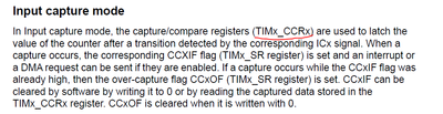

Thanks Andrew for your quick support.
Yes this will work fine for for pwm.
Also input capture compare for any pwm incoming signal will use below TIMx_CCRx
sag
Hope i can see CCR pins in datasheet for input pwm capture
