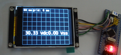

I use similar TFTs , with ILI9343 or ST7789 etc, but always using the SPI interface (less wiring and needed pins).
Writing to the picture is little slower, but as long as you dont want show a video or a fast game, but more a "info sceen" , no need for super fast picture update.

Right, see my pic...its just on a bluePill , F103 , 7 wires to display.
