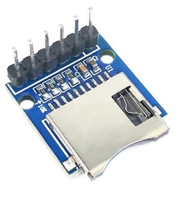

Not easy to recover a broken SDcard slot. May be you need to clean it but it's risky.
Or buy add an external SDcard slot module like this one and wire it yourself:
PS: take care of the pull up resistors mounted on the module (see the image).
