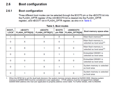

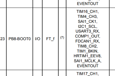

In our current case, the STM32G474 is connected by USB to our PC software. Is it possible to give the processor a command to reboot in bootloader-mode. Because the boot-pin is already in use by the I2C-bus.
Is this possible with the normal bootloader or do we need to develop our own bootloader to do this?

OK I understood what do you mean by "boot-pin", this one:
You still have the access to the ST bootloader but for that you need to use the boot modes in option bytes where the boot-pin is no more usable. Refer to the RM0440 / section 2.6 Boot configuration:

You can jump to bootloader from your application code.
Please refer to the article below:
How to jump to system bootloader from application ... - STMicroelectronics Community
For more information about system bootloader please refer to the application note below:
Introduction to system memory boot mode on STM32 MCUs - Application note

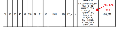

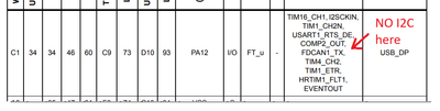

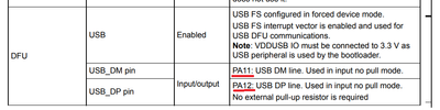

If the resources allocated to the ST bootloader (according to the AN2606) are used you need to develop your own bootloader.
But you need to provide details which pin are used by I2C? PA11, PA12?
But according the the datasheet I2C is not mapped neither on PA11 nor on PA12:
You need to refer to the AN2606 / section 50 STM32G47xxx/48xxx devices
