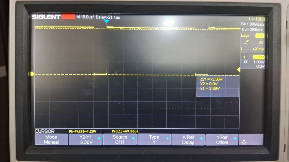

From your oscilloscope screenshot it seems you have that 0x7F which the target is waiting for:
Meanwhile I still insist on the hardware check:
1- Is there a mean to connect with the STM32H7 with STLINK?, to confirm if the chip is alive?
2- If you can connect with ST-LINK, check again your hardware and continuity between STM32H7_TX / USB-USART_Rx and  STM32H7_RX / USB-USART_Tx. You need to confirm that part and check if you are using the right pins. You could have a mismatch with what you are really doing and what you are thinking about what you did ;).

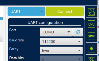

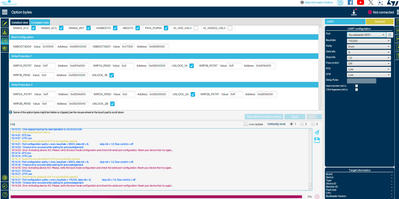

And use CubeProgrammer to connect to the ST bootloader:
USB-Serial is working fine, tested by RX-TX loopback. Still the CubeProgrammer fails to connect.
Attaching snapshot.
Did you monitor USB-UART bridge Tx with an oscilloscope during the CubeProgrammer connection?
The oscilloscope visuals seems 0x7F is being transmitted over TX.

You need to be in the bootloader in order for 0x7F to have an effect. AN2606 lists the ways to enter the bootloader. Most commonly, holding BOOT0 high during reset will enter the bootloader under most circumstances.
