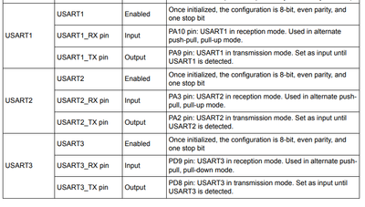

Then, connect the board to your host using one of the USART interfaces shown in the figure (USART1,USART2 or USART3, depending on your hardware).
you can also use STM32CubeProgrammer and select the appropriate USART interface when connecting to the board for firmware update.
