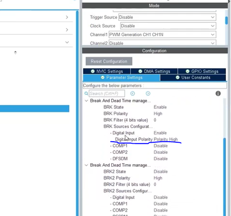

I am generating two PWMs with TIM1 CH1 and CH2 .I want to stop the PWMs when Break input is present. I have configured the STM32 Break input in the STM32cubeIDE and able to stop the PWMs when Break input is HIGH(3.3v).
I needed the reverse way now like when Break input is GND(0v) No PWMs .I have changed the Digital input polarity -Low and Break Polarity -Low but No luck .
Please suggest any ideas on this ??

Could you post some code or the CubeMX file?
Did you spotted this in the cubeMX config window already?
source

Hi Javier,
Yes I did the changes as you mentioned in the screen shot in the STMCubeIDE.below is the code
 htim1.Instance = TIM1;
 htim1.Init.Prescaler = 0;
 htim1.Init.CounterMode = TIM_COUNTERMODE_CENTERALIGNED1;
 htim1.Init.Period = PERIOD;
 htim1.Init.ClockDivision = TIM_CLOCKDIVISION_DIV1;
 htim1.Init.RepetitionCounter = 0;
 htim1.Init.AutoReloadPreload = TIM_AUTORELOAD_PRELOAD_DISABLE;
 if (HAL_TIM_PWM_Init(&htim1) != HAL_OK)
  Error_Handler();
 sMasterConfig.MasterOutputTrigger = TIM_TRGO_OC2REF;
 sMasterConfig.MasterOutputTrigger2 = TIM_TRGO2_RESET;
 sMasterConfig.MasterSlaveMode = TIM_MASTERSLAVEMODE_DISABLE;
 if (HAL_TIMEx_MasterConfigSynchronization(&htim1, &sMasterConfig) != HAL_OK)
  Error_Handler();
 sBreakInputConfig.Source = TIM_BREAKINPUTSOURCE_BKIN;
 sBreakInputConfig.Enable = TIM_BREAKINPUTSOURCE_ENABLE;
 sBreakInputConfig.Polarity = TIM_BREAKINPUTSOURCE_POLARITY_LOW;
 if (HAL_TIMEx_ConfigBreakInput(&htim1, TIM_BREAKINPUT_BRK, &sBreakInputConfig) != HAL_OK)
  Error_Handler();
 sConfigOC.OCMode = TIM_OCMODE_PWM1;
 sConfigOC.Pulse = DUTY_CYCLE;
 sConfigOC.OCPolarity = TIM_OCPOLARITY_HIGH;
 sConfigOC.OCNPolarity = TIM_OCNPOLARITY_HIGH;
 sConfigOC.OCFastMode = TIM_OCFAST_DISABLE;
 sConfigOC.OCIdleState = TIM_OCIDLESTATE_RESET;
 sConfigOC.OCNIdleState = TIM_OCNIDLESTATE_RESET;
 if (HAL_TIM_PWM_ConfigChannel(&htim1, &sConfigOC, TIM_CHANNEL_1) != HAL_OK)
  Error_Handler();
 sConfigOC.Pulse = PERIOD-DUTY_CYCLE;
 sConfigOC.OCPolarity = TIM_OCPOLARITY_LOW;
 if (HAL_TIM_PWM_ConfigChannel(&htim1, &sConfigOC, TIM_CHANNEL_2) != HAL_OK)
  Error_Handler();
 sBreakDeadTimeConfig.OffStateRunMode = TIM_OSSR_DISABLE;
 sBreakDeadTimeConfig.OffStateIDLEMode = TIM_OSSI_DISABLE;
 sBreakDeadTimeConfig.LockLevel = TIM_LOCKLEVEL_OFF;
 sBreakDeadTimeConfig.DeadTime = 0;
 sBreakDeadTimeConfig.BreakState = TIM_BREAK_ENABLE;
 sBreakDeadTimeConfig.BreakPolarity = TIM_BREAKPOLARITY_LOW;
 sBreakDeadTimeConfig.BreakFilter = 0;
 sBreakDeadTimeConfig.BreakAFMode = TIM_BREAK_AFMODE_INPUT;
 sBreakDeadTimeConfig.Break2State = TIM_BREAK2_DISABLE;
 sBreakDeadTimeConfig.Break2Polarity = TIM_BREAK2POLARITY_HIGH;
 sBreakDeadTimeConfig.Break2Filter = 0;
 sBreakDeadTimeConfig.Break2AFMode = TIM_BREAK_AFMODE_INPUT;
 sBreakDeadTimeConfig.AutomaticOutput = TIM_AUTOMATICOUTPUT_DISABLE;
 if (HAL_TIMEx_ConfigBreakDeadTime(&htim1, &sBreakDeadTimeConfig) != HAL_OK)
  Error_Handler();
