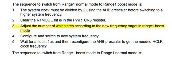

in STM32G474 , Increasing the PLL frequency to 160Mhz (max allowable) make the core lock up and the core frequency can be increead to 160MHz only if AHB is prescaled

Check internal power supply settings and Flash wait states.

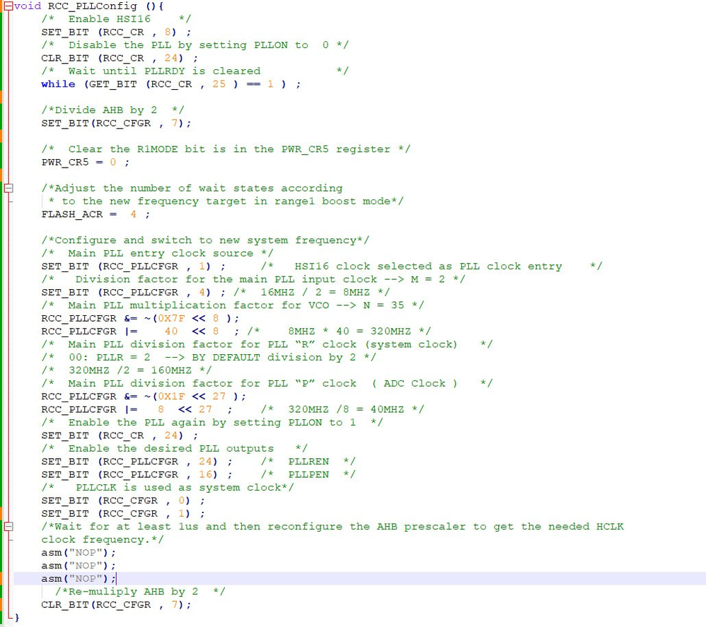

I performed these steps appended in the data sheet but during debugging the program comes to write to FLASH_ACR to adjust the number of flash wait states and gives Target is not responding.

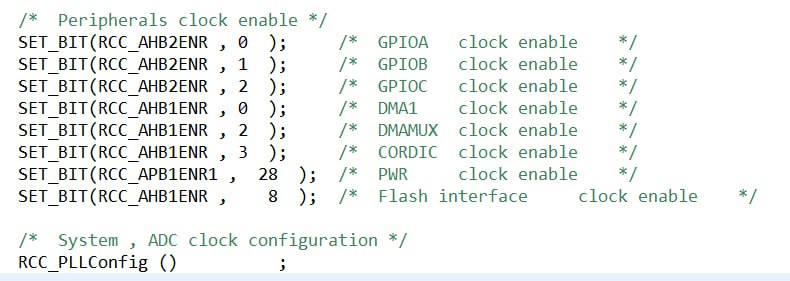

Is PWR module enabled?

I enabled the clock for Both PWR and Flash interface before Clock Configuration and the problem appears at assigning wait states to Flach_ACR register by showing the target does not respond during the debug session.

By using magic numbers instead of named constants and multiple statements to set a single register you are asking for trouble. Why not:
RCC_>AHB2ENR |= RCC_AHB2ENR_GPIOAEN | RCC_AHB2ENR_GPIOBEN | RCC_AHB2ENR_GPIOCEN;
Also, FLASH->ACR register contains some important bits set by default. So, to set wait states without turning off the debug interface, use:
FLASH->ACR |= 4u;

Thank you so much
