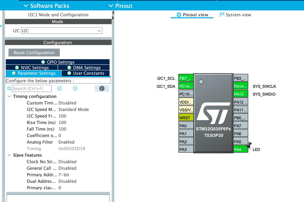

Add configuration screen of STM32G030.
Have a two boards with this chip and for both I2c are not worked.

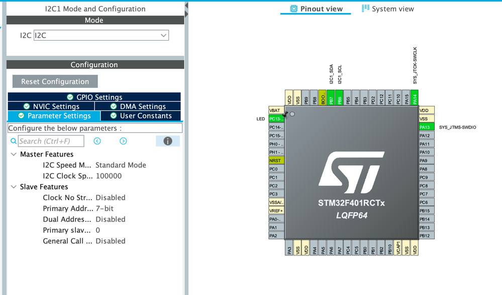

Also add config of STM32F401. Where i2c works. There MASTER section present. In STM32G030 no MASTER section.
‎2024-09-21 5:20 PM
The peripheral is different and so the configuration screen is different. But it can be an I2C master. Perhaps share your code. What does HAL_I2C_IsDeviceReady return?
