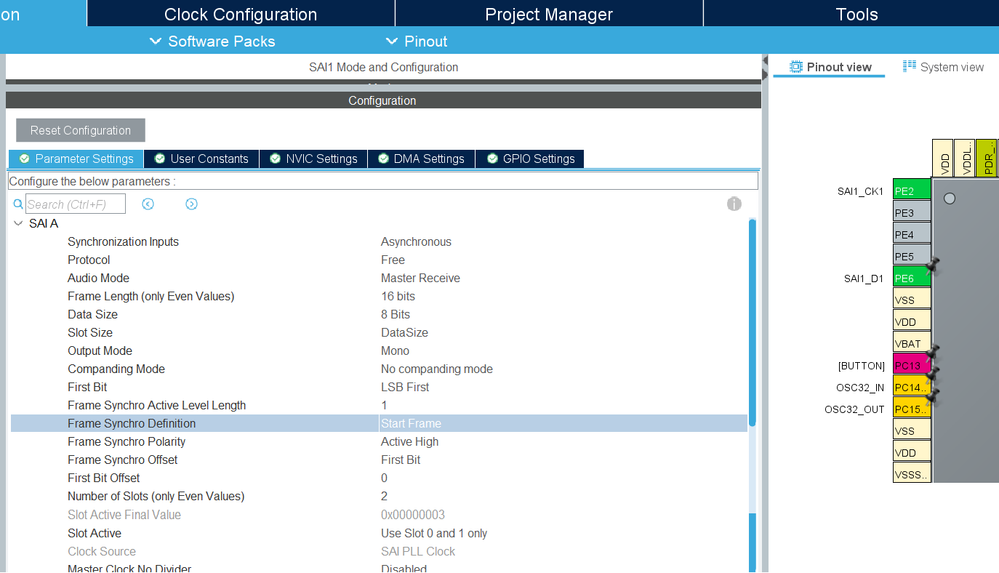

Hi, this is my first post here and one of my first experiences with the STM32.
I'm working on an STM32H7A3ZI-Q development board. I've connected an Adafruit PDM microphone to SAI1_A with clock on PE2 (SAI1_CK1) and data on PE6 (SAI1_D1). I'm not an expert on PDM microphones; I used to acquire analog data from an amplified microphone with an ADC and timer 2 (everything worked perfectly) and then transferred the data via UART to my PC, where I listened to it with a Python script.
Now I need to switch to a PDM microphone.
Now, I've configured this PDM MONO microphone to be used in PDM mode with CK1, with an 8-bit data size and a 16-bit frame, the same slot size as the data, 2 slots (the IOC forces me to use even numbers), free protocol, and asynchronous sync input.

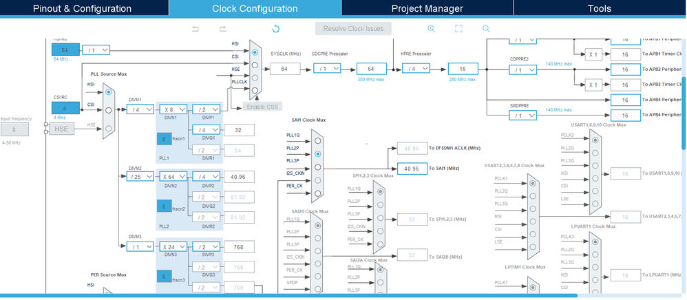

I get the peripheral clock from PLL2 and it's 40.96 MHz. I set the frequency divider after init (the HAL code generator doesn't generate the correct divider) to get a 1.024 MHz output to the microphone, and the oscilloscope shows the frequency is correct.
Reading the reference manual, it seems I need to acquire two slots, one of which is dummy (I assume slot1) and one working slot (I assume slot0).
I configured the DMA to transfer data from the SAI to RAM with automatic increments in MEM. I use the HALF and FULL DMA callbacks to process the data via software sinc1 (when it works, I'll switch to PDM2PCM or DFSDM).

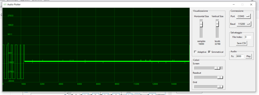

Now the problem is that I only see noise in the data from slot0 and all zeros in the data from slot1, so I've made some mistake somewhere. I suspect some misconfiguration in the SAI or PDM settings.
Any suggestions?

  hsai_BlockA1.Instance = SAI1_Block_A;
  hsai_BlockA1.Init.Protocol = SAI_FREE_PROTOCOL;
  hsai_BlockA1.Init.AudioMode = SAI_MODEMASTER_RX;
  hsai_BlockA1.Init.DataSize = SAI_DATASIZE_8;
  hsai_BlockA1.Init.FirstBit = SAI_FIRSTBIT_LSB;
  hsai_BlockA1.Init.ClockStrobing = SAI_CLOCKSTROBING_FALLINGEDGE;
  hsai_BlockA1.Init.Synchro = SAI_ASYNCHRONOUS;
  hsai_BlockA1.Init.OutputDrive = SAI_OUTPUTDRIVE_DISABLE;
  hsai_BlockA1.Init.NoDivider = SAI_MASTERDIVIDER_DISABLE;
  hsai_BlockA1.Init.FIFOThreshold = SAI_FIFOTHRESHOLD_HF;
  hsai_BlockA1.Init.AudioFrequency = SAI_AUDIO_FREQUENCY_16K;
  hsai_BlockA1.Init.MonoStereoMode = SAI_MONOMODE;
  hsai_BlockA1.Init.CompandingMode = SAI_NOCOMPANDING;
  hsai_BlockA1.Init.PdmInit.Activation = ENABLE;
  hsai_BlockA1.Init.PdmInit.MicPairsNbr = 1;
  hsai_BlockA1.Init.PdmInit.ClockEnable = SAI_PDM_CLOCK1_ENABLE;
  hsai_BlockA1.FrameInit.FrameLength = 16;
  hsai_BlockA1.FrameInit.ActiveFrameLength = 1;
  hsai_BlockA1.FrameInit.FSDefinition = SAI_FS_STARTFRAME;
  hsai_BlockA1.FrameInit.FSPolarity = SAI_FS_ACTIVE_HIGH;
  hsai_BlockA1.FrameInit.FSOffset = SAI_FS_FIRSTBIT;
  hsai_BlockA1.SlotInit.FirstBitOffset = 0;
  hsai_BlockA1.SlotInit.SlotSize = SAI_SLOTSIZE_DATASIZE;
  hsai_BlockA1.SlotInit.SlotNumber = 2;
  hsai_BlockA1.SlotInit.SlotActive = 0x00000001;
  if (HAL_SAI_Init(&hsai_BlockA1) != HAL_OK)
    Error_Handler();

  SAI1_Block_A->CR1 &= ~(1U << 27);  	// Disattiva Master Clock (Bit 27)
  SAI1_Block_A->CR1 &= ~(1U << 16);		// Disattiva SAI Block (Bit 16)
  // 3. Modifica MCKDIV (Clear & Set)
  //    a. Maschera MCKDIV (6 bit) = 0x3F, posizione bit 20
  uint32_t cr1_val = SAI1_Block_A->CR1;
  cr1_val &= ~(0x3FUL << 20); // Pulisce i bit [25:20]
  cr1_val |= (20U << 20);     // Imposta MCKDIV = 20
  SAI1_Block_A->CR1 = cr1_val;
  SAI1_Block_A->CR1 |= (1U << 27); 		// Riattiva Master Clock (Bit 27)
  SAI1_Block_A->CR1 |= (1U << 16);		// Riattiva SAI Block (Bit 16)
  /* USER CODE END SAI1_Init 2 */
