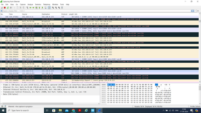

sometimes i am able to receive full packet of 14000 bytes sometimes it breaks in between.like after 7000 bytes (tcp raw lwip ,stm32f429vet6)or more it will stop receiving but stm32 pings and udp is also working at that time
But whenever i am using hercules to send 1024(last limit to send) bytes packet then i am able to send every time
I have checked in wireshark as the packet size increases ,retransmit of packet starts and then the problem arises
I am using our own software to send 14000 bytes which works fine I have checked this software with other end at computer. I am connecting stm32 with software( windows based developed on visual basic) through ethernet cable directly.STM32 being client 192.168.0.11 and Computer software being server 192.168.0.253 port 25000 tcp

please find screen shot of packets being send as atatchemnt initially it receives perfectly some packet after that retransmission occurs as seen from wireshark screenshot now i hv used packetsender standard tool to send packets in order to explain my issue properly packets are received but very late in case packet is large microcontroller is never hanged i am sending some bytes through pachetsender so that are received as i hv made one u16 variable datasrno to count the no. of bytes received

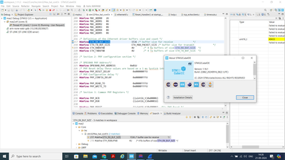

Helllo @MGOEL.1 ,
make sure you are using the lated version of cube Firmware as there was a bug reported related to V1.27
[ETH] fix constant receive buffer size by DedkovArtem · Pull Request #119 · STMicroelectronics/STM32CubeF4 (github.com)
Regards
‎2024-09-21 2:02 AM
Thanks for reply
I have checked version it is updated and #define ETH_RX_BUF_SIZE 1536 seems ok
Issue still remains unsolved still i am finding solution
