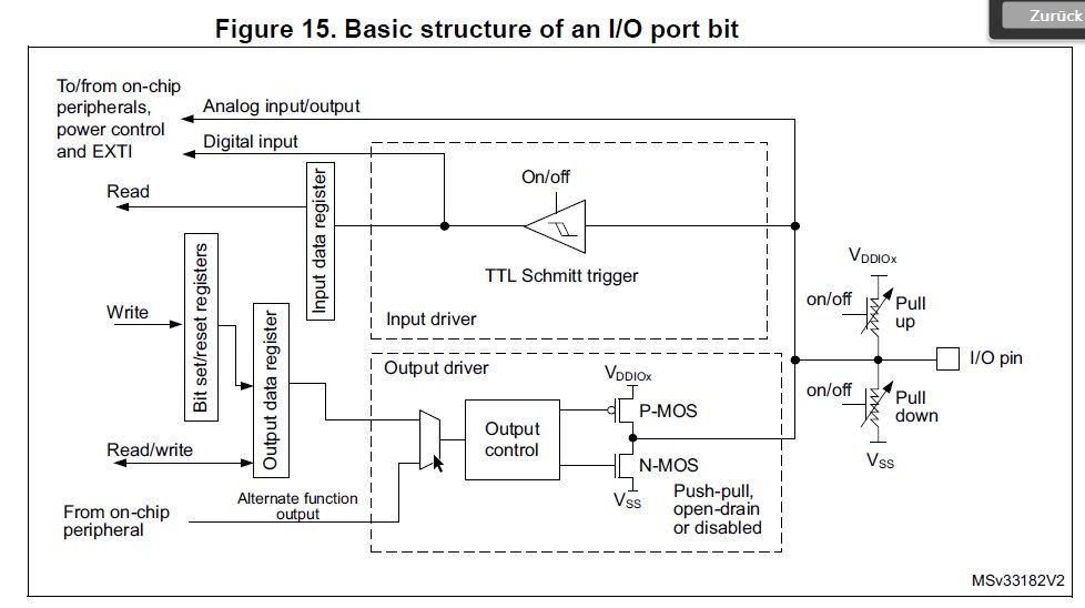

0690X00000AAQfdQAH.jpgHi,
published io port structure in STM32G0 reference manual does not show input clamping diodes.
So: Need to provide them externally ?
Or: Bug in io port sketch ?
Best regards
Juergen​
JVERN.13
​Hello
here after the correct structure for TT and FT GPIOs
For more details concerning the STM32 GPIOs don't hesitate to look at the Application Note  AN4899   "STM32 GPIO configuration for hardware settings and low-power consumption" .  This A.N. is available on the web st.com
Best regards

Is G0 gpio the same as L0 gpio ?
Ozone
Principal III
Other STM32 manuals sometimes state that images are symbolic, i.e. show just functional elements.
Very little information about implementational details like clamping diodes.
You would need to ask ST - or wait until competent ST staff bothers to answer here.

JVERN.13
Sorry
The Copy ​did not work  in my first answer.  Please find joined the STM32 GPIOs structure  for  TT and FT  IOs
Regards
JuM
Senior
​Thank you very much for this valuable info!
