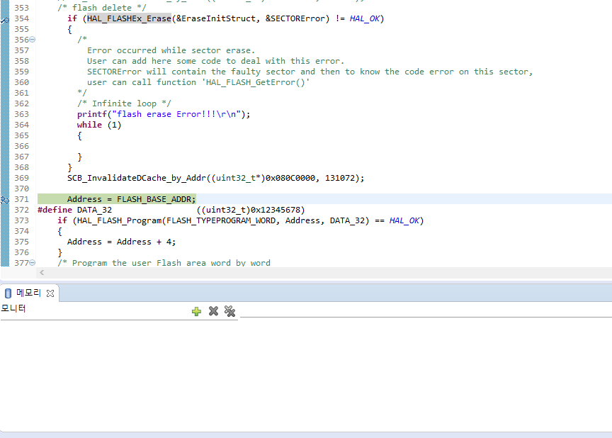

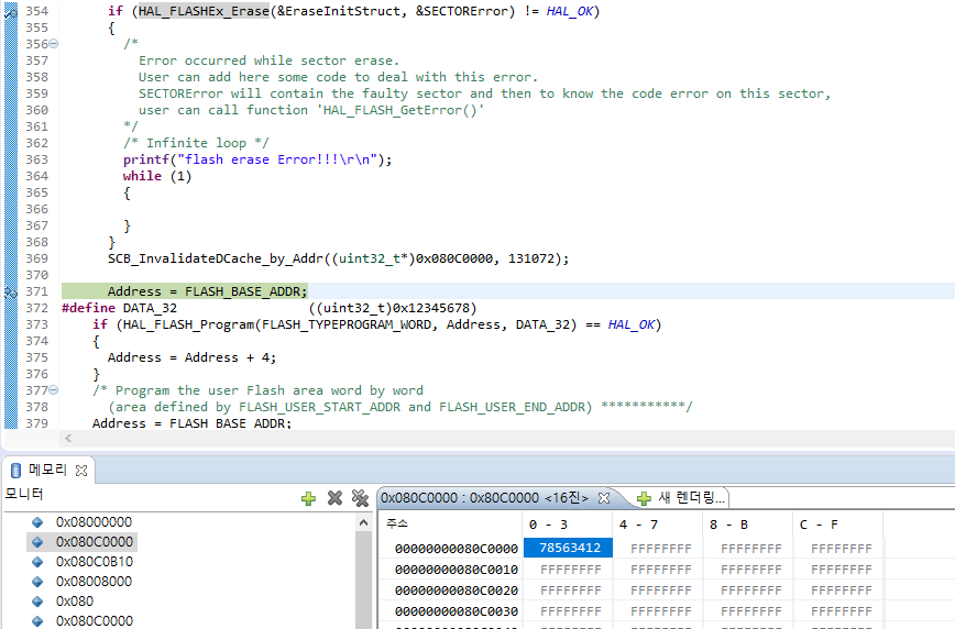

I excute the program step by step using debbugger.
In nucleo-144, when the program execute
if (HAL_FLASHEx_Erase(&EraseInitStruct, &SECTORError) != HAL_OK)
the flash is set 0x12345678 to 0xFFFFFFFF (I've seen this in truestudio in 0x080C0000)
but the my board which have stm32f767IGT6
when the program execute if (HAL_FLASHEx_Erase(&EraseInitStruct, &SECTORError) != HAL_OK) the flash doesn't set 0x12345678 to 0xFFFFFFFF
it only show me 0x12345678. even it said "HAL_OK".

// here should be erased flash. but it says "HAL_OK". but flash is not erased
Why there still isn't cache invalidation at this point? Why are you still keeping it before erase operation and commented out? So what is the memory content immediately after erase and cache invalidation? What is the memory content if you comment out further data programming and look at memory with ST-LINK Utility after disconnecting and reconnecting the power supply?

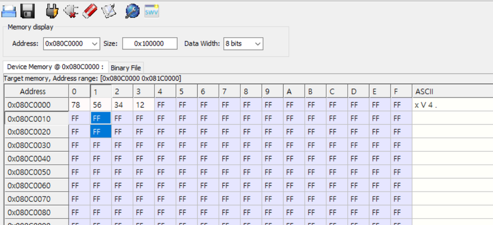

  1. I erased flash using "STM32 ST-LINK Utility"(because, if don't erase, truestudio show me the errer i said above). and downloaded the program using debugger in truestudio. some reason on first executing, truestudio does not show me the memory
2. So i execute rest of my code and restart the debugger, then i could see the memory.
3. I disconnected power supply, and i reconnecting power supply. and connect with ST-LINK_UTILITY.

You still have HAL_FLASH_Program() called after erase. Do the erase without it (comment it out) and then look at memory with ST-LINK Utility!
  1. downloaded the firmware which include HAL_FLASH_Program();
  2. look memory with stm-link-utility
memory 0x080C0000 : 78563412 FFFFFFFF FFFFFFFF FFFFFFFF
3. downloaded the firmware below which is removed HAL_FLASH_Program();
. and truestudio show me the error but i ignore that
message. and close debug and see the memory with STM32-LINK-Utility
