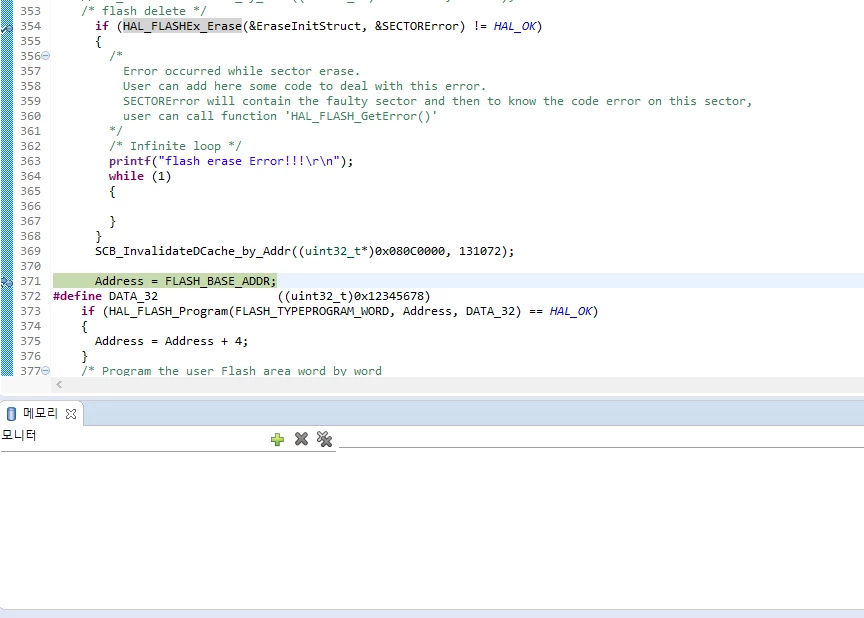

SCB_InvalidateDCache_by_Addr((uint32_t*)0x080C0000, 131072);
/* flash delete */
 if (HAL_FLASHEx_Erase(&EraseInitStruct, &SECTORError) != HAL_OK)
   Error occurred while sector erase.
   User can add here some code to deal with this error.
   SECTORError will contain the faulty sector and then to know the code error on this sector,
   user can call function 'HAL_FLASH_GetError()'
  /* Infinite loop */
printf("flash erase Error!!!\r\n");
  while (1)
I program like this, but it didn't work.
How do i use this function correctly?
  /* Infinite loop */
  while (1)
Sorry, i changed.

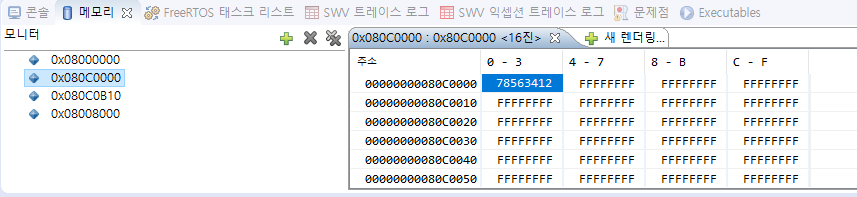

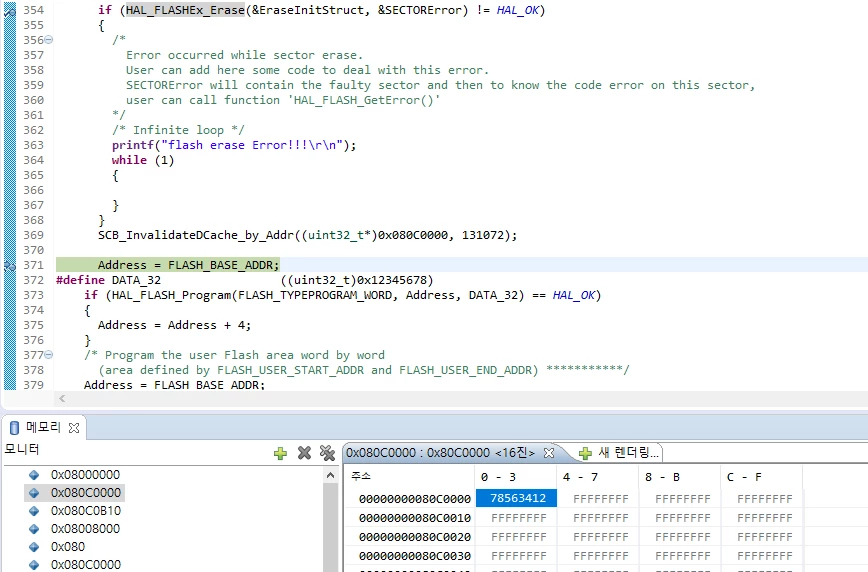

  1. I erased flash using "STM32 ST-LINK Utility"(because, if don't erase, truestudio show me the errer i said above). and downloaded the program using debugger in truestudio. some reason on first executing, truestudio does not show me the memory
2. So i execute rest of my code and restart the debugger, then i could see the memory.
3. I disconnected power supply, and i reconnecting power supply. and connect with ST-LINK_UTILITY.

You still have HAL_FLASH_Program() called after erase. Do the erase without it (comment it out) and then look at memory with ST-LINK Utility!

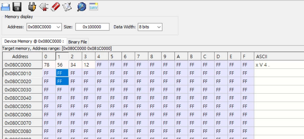

  1. downloaded the firmware which include HAL_FLASH_Program();
  2. look memory with stm-link-utility
memory 0x080C0000 : 78563412 FFFFFFFF FFFFFFFF FFFFFFFF
3. downloaded the firmware below which is removed HAL_FLASH_Program();
. and truestudio show me the error but i ignore that
message. and close debug and see the memory with STM32-LINK-Utility
