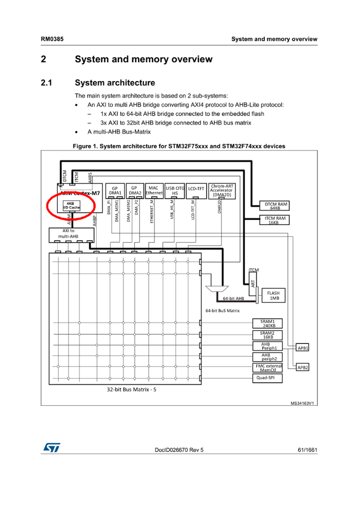

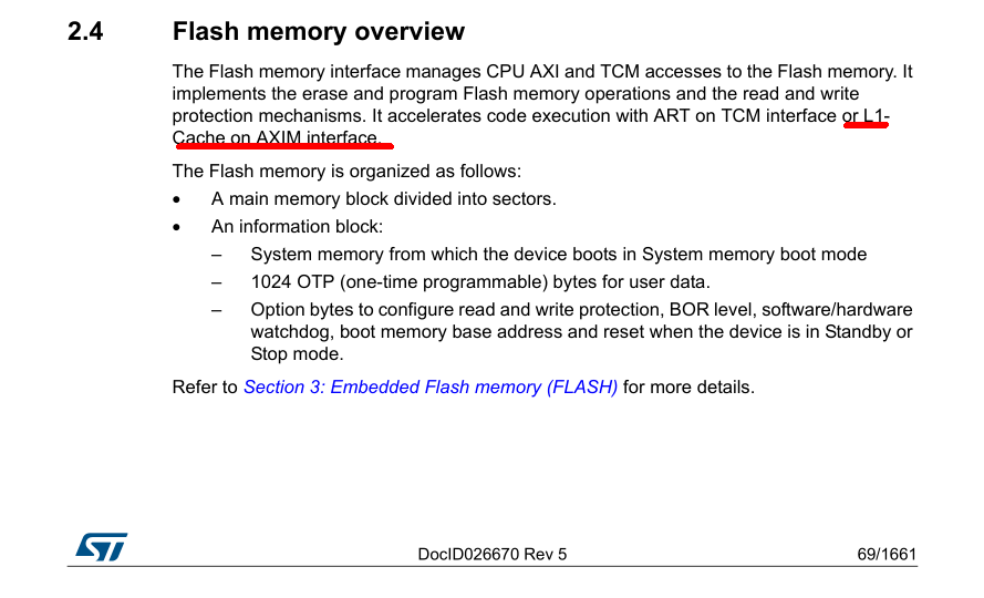

The only explanation for this behavior that I can think of is the relative positions of these two tasks in memory affects how the code is cached by the CPU. This is where I'm puzzled, however. According to the datasheet, only FLASH on the ITCM interface uses the ART accelerator. My code is in the FLASH on the AXIM interface.
Is there another instruction cache different from the ART accelerator? Is there any way to disable it to check whether it's the cause of the effect I'm seeing? I didn't find anything in either the datasheet or the reference manual.

Read AN4839 and AN4838.
‎2017-07-09 4:39 PM
Interesting. Thank you. I missed that in my reading of the manual.
I read those two app notes and better understand the relationship between the L1 cache and FLASH.
