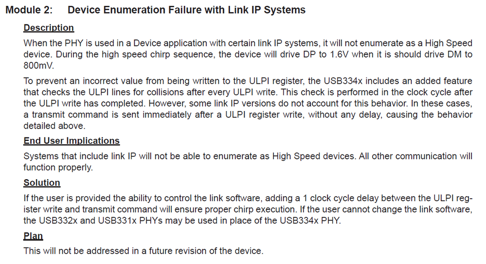

I have a custom H743 board with Microchip USB3340 external PHY (REFCLK = 24MHz, dedicated external oscillator)
In an code that use ChibiOS, my configuration should achieve HS mode, but ultimately, after handshake, it revert to FS mode (12Mbits/s) : so it works, but it is slow.

alexandre23
Problem solved reading this thread on the forum : https://community.st.com/t5/stm32-mcus-embedded-software/stm32f2-f4-problems-with-various-ulpi-usb-phys/m-p/554263#M40349
this is also documented as an errata section on microchip 334x PHY manuel.
TLDR : setting XCVRDLY bit in the DCFG register solve the problem when using recent ULPI PHY like the microchip 334x.
Alexandre
