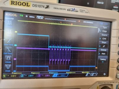

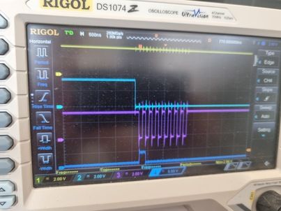

This is the example screenshot from a oscilloscope. Yellow not seen is the trigger signal to ADC chip. Blue is output busy signal from ADC chip. Output from ADC is 16-bit and directly connected to gpio, one full bank so GPIOC->IDR should contain the values. Target is to send 8 pulses to read ADC values from chip. This is the purple signal.
So in this case I have setup timer 1:
Slave trigger on ADC busy signal, this will generate 8 active low signals towards the ADC. This is output through TIM1_CH1 as OC using PWM. It is setup a one pulse to generate 8 output active low pulses with the help of PWM with repetition count of 8.
ADC output will be stable on rising edge of the purple timer output. The goal is to trigger DMA periph (GPIOC->IDR) -> memory in a double buffered way.
So how do I setup that the timer triggers DMA transfers. Each pulse on the timer generates 8 active low signal and I need to trigger the DMA on rising edge of that output.
Using DMA2->Channel 6, Stream0 only generates one transfer per pulse and not 8, one per repitition.
Using DMA2->Channel 6, Stream1 generates 8 transfers per pulse and I can read ADC values on the resulting buffer. However I cannot find information how this is timed since I need the DMA trigger to be at the correct flank.

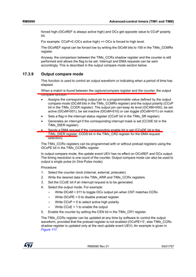

> But I cannot find any documentation about what this exactly is
If TIMx_CHx is set to Compare (as opposed to Capture), TIMx_CHx event is generated upon a match, i.e. when TIMx_CCRx == TIMx_CNT:
(used 'F4 RM as that's what I have open right now, but in this regard all STM32 are the same).
In your case, that would be at the falling edge, which is what you don't want. As I've hinted above, you can visualize the moment of sampling yourself (okay there might be a few cycles difference between input and output, but you get the point).
What you can do is to set up a different channel TIM1_CHy of the same TIM1 timer to Compare at 0 (which incidentally is the reset setting), enable DMA from that TIM1_CHy in TIM1_DIER, and set up DMA to be triggered from that channel.

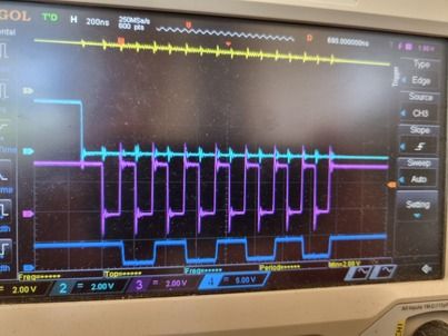

As suggested above I setup the DMA to instead output to a spare gpio to visualize the timing. The buffer is just alternating 0/1.
DMA2 stream1, ch6 = TIM_CH1:
Unfortunately this shows that the timing is not correct and the timing is on falling edge instead of rising edge.

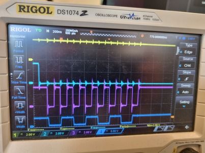

If I instead setup DMA2 stream5, ch6 = TIM_UP:
Here we get the trigger only on the last rising edge and not all. I also get an extra at the start as well.
