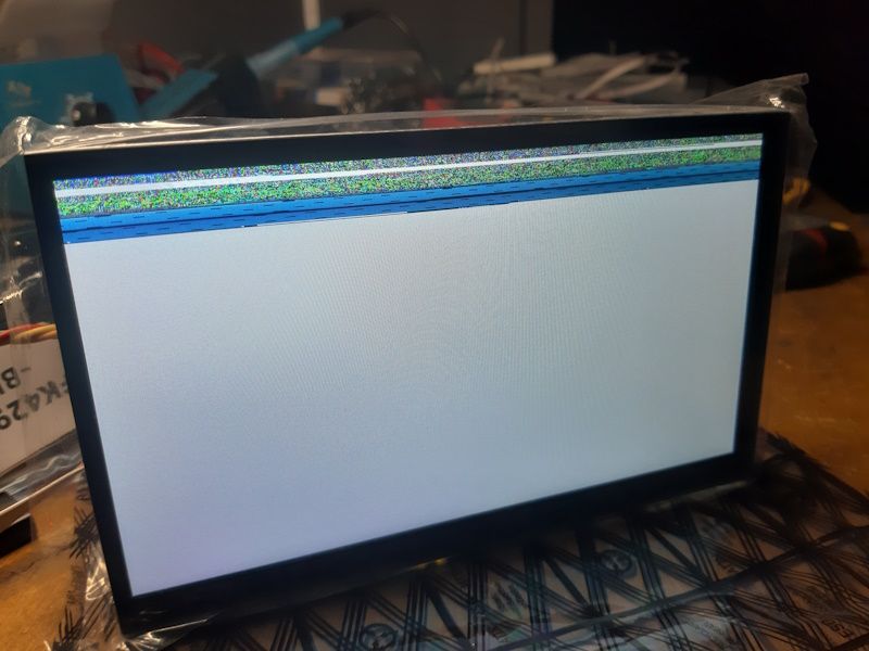

I am starting some test with this module
https://it.aliexpress.com/item/1005002482177244.html
with 7” lcd
I have found only one example that run but with Touchgfx
I have got the same ioc from this example to generate a new code and insert the functions to switch on lcd but still no result
I would like to use the normal functions
BSP_LCD_Init() ;
BSP_LCD_DisplayStringAt(10, 80, buf, LEFT_MODE);
BSP_LCD_DrawBitmap(0, 0, (uint8_t *)(&BackGround0));

2024-04-23 10:28 PM
What's the Pixel Clock ?
If you fill the frame buffer with random data do you get a colourful pattern?
2024-04-23 11:13 PM - edited 2024-04-23 11:24 PM
Until now I see only a blue screen

2024-04-24 2:08 AM
and this hang the system

2024-04-24 6:00 AM
Hangs the system, or Hard Fault's ?
Have the HardFault_Handler() output some actionable data, rather than silent death in while(1). Similarly Error_Handler()
Hard Fault would suggest the SDRAM is not working or at wrong address. Check SDRAM, check pointers.
What does Cube say about PLL SAI settings for 33.33 MHz ? Also #define / #ifdef use different key word.

2024-04-24 6:21 AM
>>but not work
Ok but your Cube project had HSE at 25 MHz, and the prescaler in the PLL as 15, so the comparison frequency is 1.6667 MHz
Your primary PLL multiplier is 144, getting the VCO to 240 MHz, and CPU at 120 MHz
Check what the LTDC clock is in your Cube Clock Tree, rather than lift codes from the other app with different expectations.
a) Confirm the 60 value relates to 25 MHz LTDC / PIXEL CLOCK
b) Confirm the 80 value relates to 33.33 MHz and doesn't violate any parameters Cube is checking.
#define KO2 --> NOT RUN, perhaps no clocking at all, as names different

2024-04-24 7:59 AM
Ok, need to understand the hanging. Check the Hard Faulting situation.
Blue / Black doesn't make a lot of sense.
Try pointing the LTDC Frame Buffer at the 0x08000000 FLASH address, should see more colourful data reflective of the opcodes in the firmware, and perhaps white when it gets to the 0xFFFFFFFF patterns.
Trying to establish if the issue is with the memory transfer, or the timings, or something else
The minimum frequency in the screen spec is 26.4 MHz
2024-04-24 11:21 AM
if (HAL_LTDC_Init(&hltdc) != HAL_OK)
Error_Handler();
pLayerCfg.WindowX0 = 0;
pLayerCfg.WindowX1 = 799;
pLayerCfg.WindowY0 = 0;
pLayerCfg.WindowY1 = 479;
pLayerCfg.PixelFormat = LTDC_PIXEL_FORMAT_ARGB8888;
pLayerCfg.Alpha = 255;
pLayerCfg.Alpha0 = 0;
pLayerCfg.BlendingFactor1 = LTDC_BLENDING_FACTOR1_CA;
pLayerCfg.BlendingFactor2 = LTDC_BLENDING_FACTOR2_CA;
pLayerCfg.FBStartAdress = 0x08000000 ; // x 0xD0000000
pLayerCfg.ImageWidth = 800;
pLayerCfg.ImageHeight = 480;
pLayerCfg.Backcolor.Blue = 0;
pLayerCfg.Backcolor.Green = 0;
pLayerCfg.Backcolor.Red = 0;
