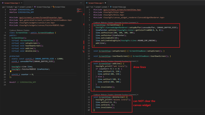

Hi @GaetanGodart @MM..1
I am trying the canvas widget, it seems to work, but still some issues:

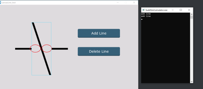

The code above is trying to draw an "X", but the second line overwrites some area of the first line, as below:
And the delete button can NOT clear the canvas area, how to do it?
Thank you!
(The project is uploaded as Attachment.)
You require more line objects one for each. Too init line is better place into setup func after base call.
For your idea you declare array lines ...

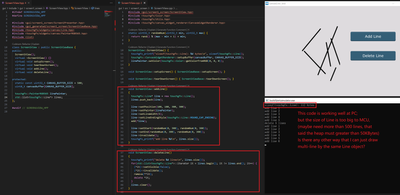

Hi @MM..1
According to your help, I can add and delete the line dynamically.
The code and the phenomenon as below:
As the result in above picture, it is work well, but need to much heap.

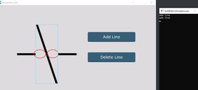

In my last version(picture below):
I set the color of line painter to RGB565, is any possible to change the painter color to ARGB2222 to resolve the overwrite problem(may the alpha value can control the overwrite area)?
I want to try, but don't know how to change the color format, it should be similar with following code:
touchgfx::PainterARGB2222 linePainter;
linePainter.setColor(touchgfx::Color::getColorFromARGB(0, 0, 0, 0));  // compiler err
Thanks very much!
