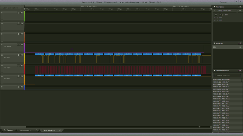

Hi.
First of all, the essence of my problem is already described here - https://community.st.com/s/question/0D50X00009XkiXu/spi-dma-data-corruption?t=1567119350874
In my case bug happens randomly and not very often. It could be one corrupted transaction among hundreds-thousands.
For example, how it is should work:0690X000009akJJQAY.png
First byte always is 0xAA.

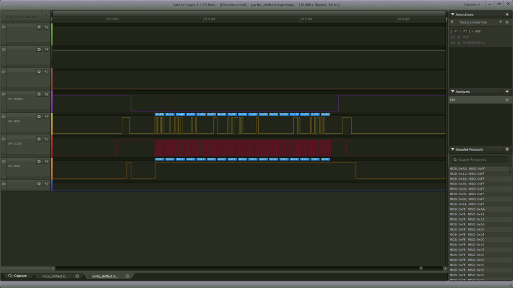

Here is an example of corruption:
You can see that CLK signal has already started, but data on MOSI is delayed by 5 bits (not constant, can be 4, 3...).
My code: https://pastebin.com/X3CfdH4q
And settings: https://pastebin.com/GKWTC1QH

How entire transaction looks:
The beginning of it (in this case I send all 0xFF bytes):
And the end:

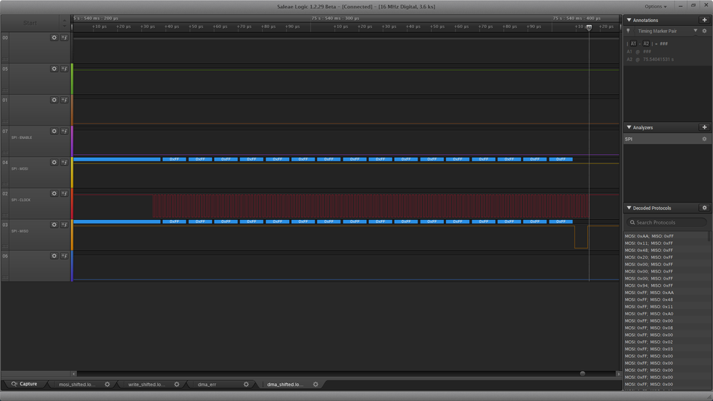

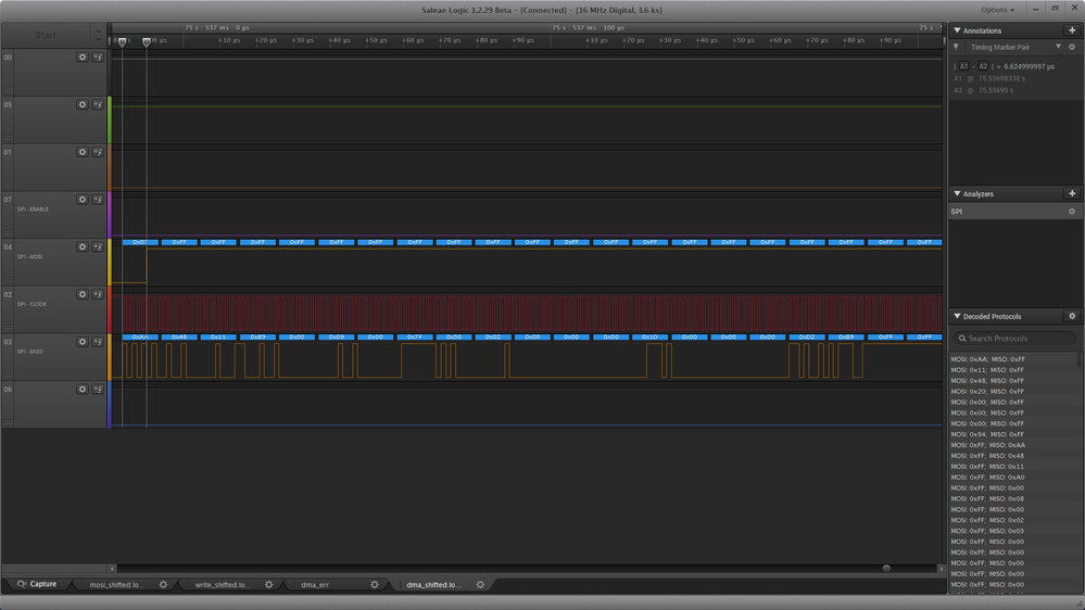

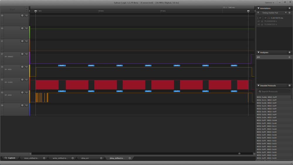

waclawek.jan
> The last transfer before corrupted one was fine,
How do you know? Post scope/LA pictures.
