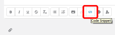

Use the 'Code Snippet' button to properly post source code:

Go on - does that code look clear and easy to read to you?
