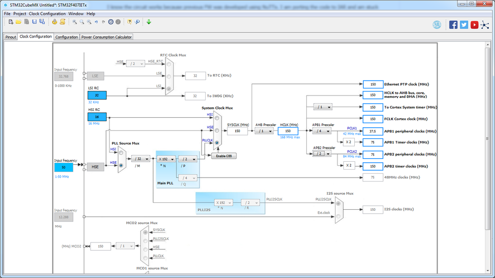

And, once this is setup, can the HSE be treated as 25MHz in order to set the other parameters? I.e. PLL_N, PLL_Q, PLL_M, etc?
No, treat it simply as 50MHz... As far as PLL is concerned, the simplest way is to take the parameters you had for 25MHz and multiply the predivider (PLL_M) by two.

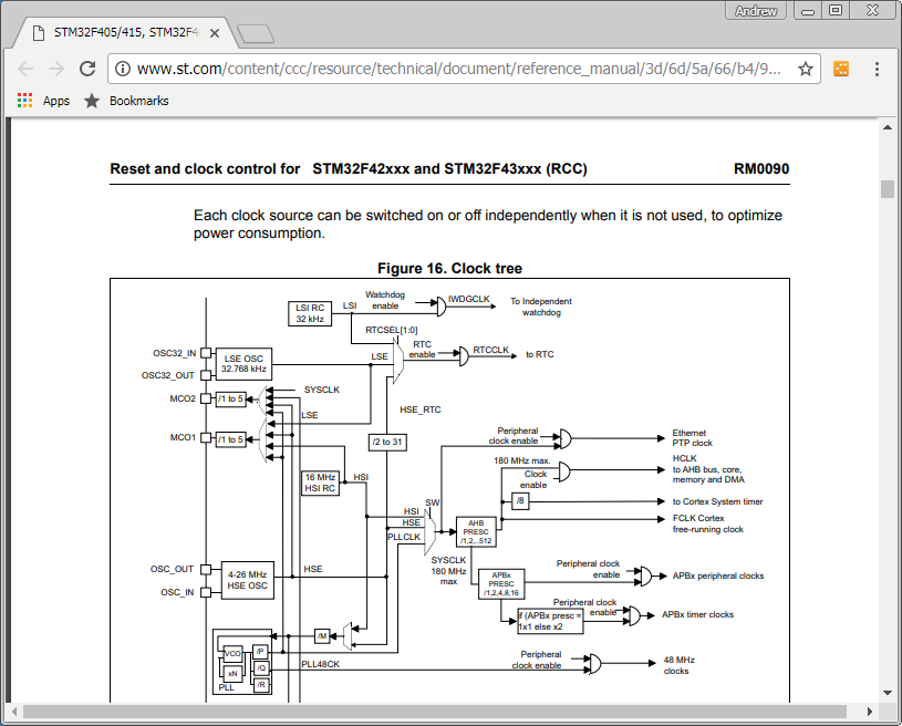

Posted on March 21, 2018 at 15:56
Surely, 6.21 from the Ref Manual (above) covers it?
6.2.1 HSE clock
The high speed external clock signal (HSE) can be generated from two possible clock sources:
? HSE external crystal/ceramic resonator
? HSE external user clock
Once you have the HSE signal, it is irrelevant whether it was derived from a crystal or an external oscillator .
See Fig 16:0690X0000060ACQQA2.png

For some reason I don't see anyone mentioning the obvious - STMCube clock manager.  You can set 50MHz and then tweak away at the internal dividers  This is an example.  It can produce the necessary clock setup code only if that's what you want.
