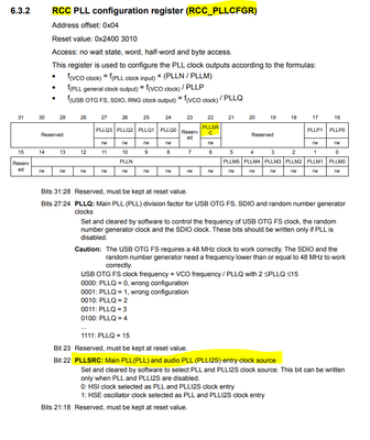

I want to understand "which register decides whether HSI or HSE oscillator is selected for PLL clock source in STM32F407"(selection of the HSI or HSE oscillator as PLL clock source"

Hello @Ash1
According to the RM0090, the PLL source is selected throw the PLLSRC bit of the RCC_PLLCFGR register:

Andrew Neil
See the Reference Manual - it will be linked from the 'Documentation' tab on the Product Page for the chip.
You'd need to give the full part number (not just STM32F407) to get to the correct page.
You can also configure it graphically using CubeMX (either standalone or within CubeIDE), then examine the generated code.
