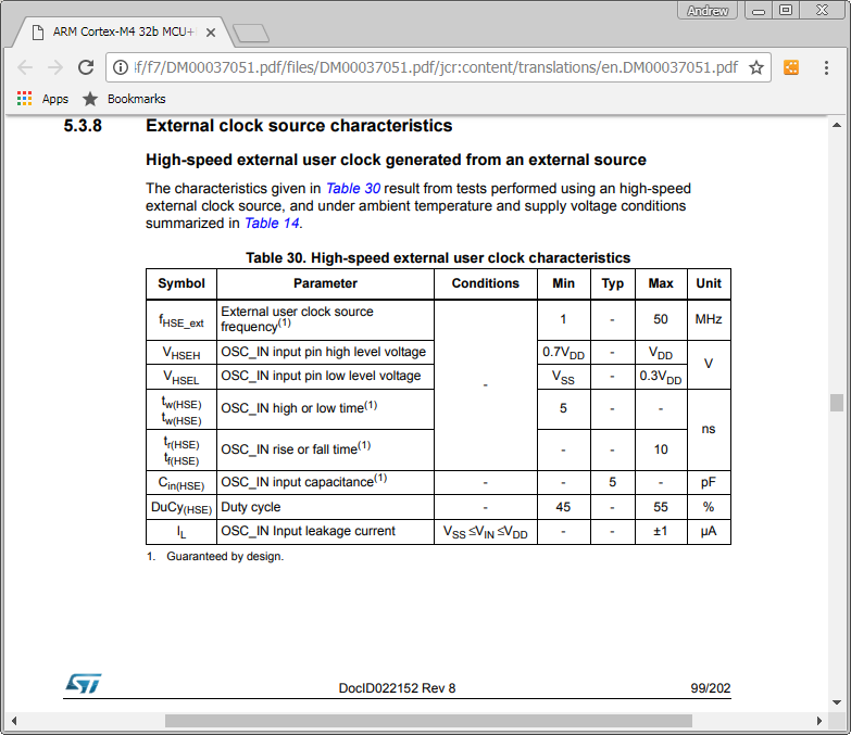

I am running an STM32F407 with an ECS-2033-500BN Oscillator (50.0MHz) to accommodate the MCU and the ETH off the same oscillator. The circuit uses a fanout buffer to distribute the clock. Nowhere can I find information on how to configure the STM32F4 system clock with this high of a value (I assume there's a divide by 2 enabled in the bowels of the MCU) and the Clock Configuration tool doesn't help. Any suggestions? And yes, I've looked through the forum and the datasheet and I haven't been able to get the circuit to run.
I know the circuit works because previous FW was developed using NuTTx. I am porting the code to IAR and am stuck at the PLL initialization in the generated file system_stm32f4xx.c at the line:
/* Wait till the main PLL is ready */
while((RCC->CR & RCC_CR_PLLRDY) == 0)
Any help would be greatly appreciated.

With external clock source you should set HSE to BYPASS.
To which pin is the clock connected?
You can check it with outputting HSE to MCO pin.

50 MHz seems a bit high  - officially (DS) only quartz frequencies from 4.0 MHz to 24.0 MHz are supported.

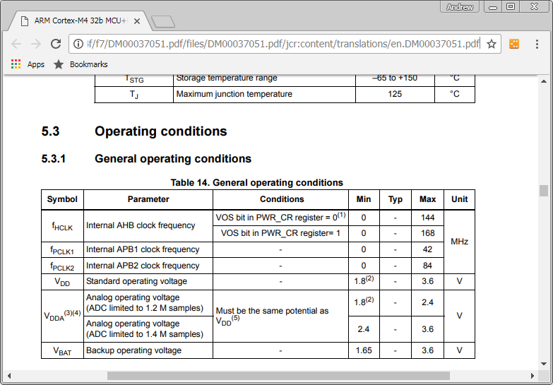

Actually 50MHz is allowed - it is the max:
http://www.st.com/content/ccc/resource/technical/document/datasheet/ef/92/76/6d/bb/c2/4f/f7/DM00037051.pdf/files/DM00037051.pdf/jcr:content/translations/en.DM00037051.pdf

Yes, AvaTar, that's what tripped me up as well. Also, the Clock Configuration tool does not allow 50 MHz.
Posted on March 21, 2018 at 14:15
Thank you, Andrew, for the reply. The datasheet, DM00037051.pdf, mentions the 50 MHz OSC in Figure 98, but doesn't really provide any more information. The reference manual, en.DM00031020.pdf, is what I was missing. However, other than the bypass, it doesn't provide the same level of detail as the Clock Configuration tool.

I didn't check the datasheet in detail, just relied on the 'front page information' - my bad ...
