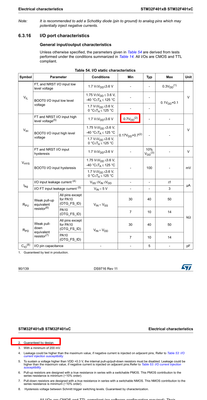

So table 54 Vih for 5V tolerant pins is 0.7Vdd. For Vdd 3.3V this is 2.31V.
I'm having input capture trigger on signals that only reach 1.8V with 100% consistency on 4 pins.
Most stm32f4 the Vih for the same pins is 0.45Vdd + 0.3V, which would be 1.65V, however this is not the case for stm32f401.
So what is going on, did the datasheet incorrectly record Vih for f401 or is something else happening?

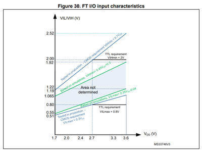

KDJEM.1
Hello @TonyFauci ,
These 2 formulas are correct  Vih = 0.7x Vdd is the threshold tested in production and Vih=0.45xVdd+0.3V is the threshold guaranteed by design.
This behavior is mentioned in data sheet figure 30: in blue the threshold level tested in production and in green the threshold level guaranteed by design.

Hi Kaouthar,
The 'F401 datasheet says otherwise, and probably it's a documentation error:
I'd recommend to review the DS.
@KDJEM.1
Hello @waclawek.jan ,
Yes, I confirm it is a documentation error and I reported internally for correction.
Internal ticket number: 163227(This is an internal tracking number and is not accessible or usable by customers).
Thank you :).
Kaouthar
