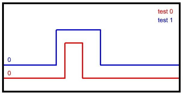

So, here the situation.
There is high priority asynchronous external interrupt and low priority systick interrupt. In EXTI handler I disable all interrupts and make pulse on test output 1 In SysTick - pulse on test output 0. And the weird part - on the logic analyser (drawing below).
So in EXTI handler, with no interrupt enabled(!) Systick interrupt appears...

It's obviously something wrong. All priorities in NVIC->IP and SCP->SHP are ok, but still I'm getting this wierd behaviour. And not only by SysTick. CAN interrupts causes same stuff...
