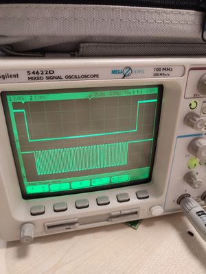

The first picture shows the clock signal of the burst and the BUSY signal. As expected, BUSY is pulled LOW before the data burst and pushed HIGH after. 
The second picture shows the clock signal of the burst and the TIMDBG signal. As expected, the TIMDBG signal is pushed HIGH right after data burst (caused by rising edge of BUSY signal). However TIMDBG doesnt stay high for the entire dataframe, but goes LOW after a few bits. This means, that my receive complete callback is called before receiving the complete package. So I have to assume that my data is corrupted. Why is that? Do you have any troubleshooting tips how I can find the reason for this early callback call? Are thres ome other interrupts I have to exclude?

The SPI has a 4-byte RXFIFO which may be keeping data and preventing you from resyncing. If it starts out of sync, it will remain that way.
Where you do TIMDBG_START, also read out the contents of the RXFIFO so that it starts from empty when the call happens. Something like this.
spi_handle.Instance->DR;
HAL_SPI_Receive_DMA(&spi_handle, spi_data, LTC2440_FRAMESIZE);

Sorry for my late response. I had to work on some other project the last days. However, it turned out, that it helps to read all contents of the RX FIFO as decribed by TDK and darenluie. Thank you very much for your help.
