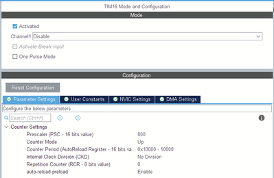

I've reduced my MX configuration down as much as possible so that it only has SWD and a button on GPIO PA8 configured and the incorrect behaviour still occurs. The intent is for PA8 EXTI falling edge to start a timer, and for that timer to in turn interrupt on expiry. I do get an interrupt (for both EXTI and the timer), but the duration of the timer is always wrong (sometimes instant, sometimes quite slow), and when on interrupt I check instance->CNT it is always a random value.

Because __HAL_TIM_GET_AUTORELOAD returns an unexpected value that does not make sense for my configuration an unsigned 16-bit value that didn't perform sign extension to 32 bits as I was originally assuming it would, and the effective delay is not what I expect.
TIM16 is a 16-bit counter. You cannot set its period to anything above 65535. Timer counters are positive. You cannot set it to -10000.
I know that the timer counter is positive; but writing in a negative value casts to an unsigned integer that has the same effect as if it were signed for the purposes of overflow behaviour. I know that TIM16 is a 16-bit counter, but in TIM_TypeDef both ARR and CNT are 32-bit.
If you want it to fire after 10000 ticks, set ARR (period) to 10000, set the counter to 0, generate an update event to load the ARR value, clear the UIF flag, and start the timer.

When you start the timer, set its counter to 0 first.
It's an up-counter, and so what I actually want to do is set it to -10000. When I do that it works well. That raises a (perhaps even stranger) question: why is the following not successful?
__HAL_TIM_SET_COUNTER(htim, __HAL_TIM_GET_AUTORELOAD(htim);
When I check the value of __HAL_TIM_GET_AUTORELOAD I see 65527, which is neither 0x1_0000  - 10000 nor 0x1_0000_0000 - 10000; so I don't know where it's coming from. My mistake; configuration de-sync issue.
Or, if you leave the default period at 65535, you can set the counter to 65535-10000 and start it.

I have most of my answer: the HAL uses a 32-bit unsigned value for ARR, and doesn't perform sign extension when converting from any 16-bit value written in the MX UI.
You wrote "0x10000 - 10000" in the MX UI. This is an unsigned value equal to 55536, so that's what it uses. You're not writing a negative value.
Not that it matters much, but for my purposes you're mostly wrong. Two's complement doesn't really care about signedness at the hardware level, and it's perfectly valid to interpret a number close to the field capacity to be negative. Indeed, outside of MX, I'm literally loading -10000 and it works as expected.
