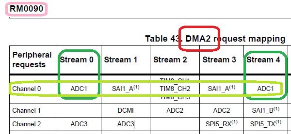

Hi, I am trying to use 4 adc channels with adc 1 and dma 1 stream 0.I don't know why but it seems that the dma isn't doing its job.

‎2015-01-14 8:56 AM
DMA2
‎2015-01-14 9:00 AM
‎2015-01-14 11:55 AM
I update the code as follows . The DMA seems to work now ONLY one time :I concluded that because the values never change when i debug the program.

‎2015-01-14 12:56 PM
Looks to be interrupting far too frequently (every 60 ADC cycles), I don't have time to rack up the code at the moment.
Why would you not get all 20 samples and THEN interrupt? Have two buffers, so the DMA isn't overwriting the buffer you're working on. Not sure what debugger you're using, or how frequently it updates the memory view, but the most practical method to determine it's working is to have the interrupt toggle a GPIO/LED, and then measure the period on a scope.Up vote any posts that you find helpful, it shows what's working..
