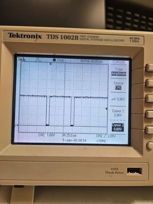

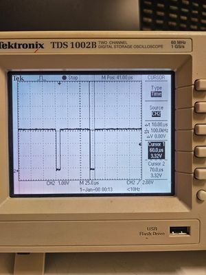

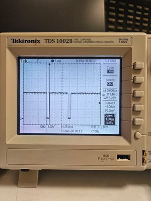

I tried probing Tx and Rx lines on CH340 module.
On Tx line I can see pulses like below when I press Connect button on Stm32 Cube programmer. But on Rx line I'm seeing no pulses but it is always high at 3.3V.

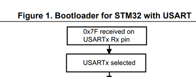

This is the 0x7F byte sent to the STM32:

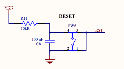

I'm doubting Reset pin. Our Reset should be high and when we press button it should go low and come back high again. But in our case, This RST net is always low even after pressing the button. I'm checking that now. Thanks for your all the replies.
