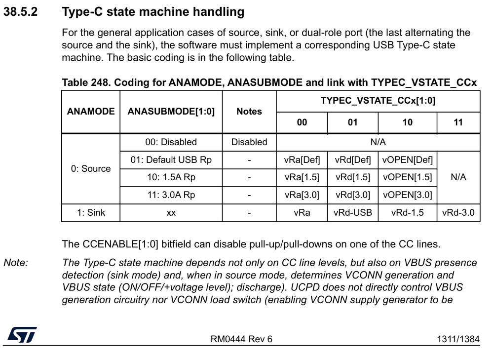

RXORDSETEN is just a convenient way to filter certain types of message, UCPD does allow snooping/monitoring messages destined for the cable like SOP’.

Hi @JamesC
If the CC analog function is disabled via ANASUBMODE being disabled, the remaining observation of the line can only be done through an external sensing method such as ADC based polling. This is a workaround, not a supported silent Type-C / EMarker operating mode.

Summary of what the example is doing:
  1. Configure the analog path
    • Set ANAMODE = 0
    • Set ASASUBMODE = 0x00 (disabled)
2- Based on demo provided
