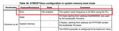

The MCU starts from the internal HSI. There is no way to check the MCU clock.

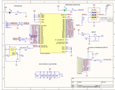

Hello, here is my schematics.
F1_STEERING_MODULE_SCH.pdf
Since our device can be powered not only by USB, in one of your document, it is mentioned we should use PA9 of VBUS sense(USB VBUS). This resulting in using PB6 and PB7 as UART. But we had a connection for PA9 and PA 10 to some header, we are using that header pins for UART line. We checked voltage levels of Boot lines that is as expected as it is supposed to be and also we checked continuity of the tx, rx lines which are proper only. We got assembled our components from JLCPCB. We checked two boards. All two boards throwing same issue.

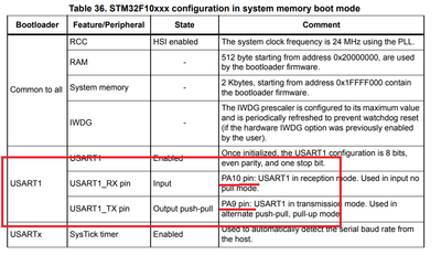

You can't use all USART IOs for the bootloader. There are specific pins for that. For STM32F103, you need to use USART1 with PA9 and PA10 no other options. Please refer to the AN2606  /Table 36:
You can't use PB6 and PB7.

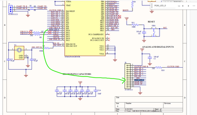

From your schematics, PA9 (USB_VBUS) and PA10 (PGM LED) are used for other stuff:
So not possible to use the bootloader in a such configuration. You need to keep These IOs free for only USART and Bootloader usage.

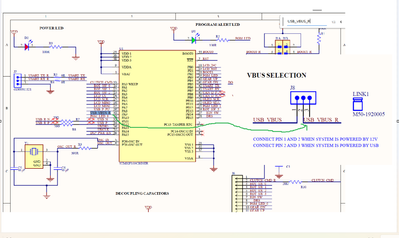

That's what I mentioned in my previous message. Yes, in schematics it is routed as PB6 and PB7 for UART.  But, after reading AN2606, we are using PA9 and PA10 as UART lines. Since PA9(J8 pin 2) and PA10(J6 pin 9) are routed to some headers, it is giving us flexibility to use them as UART lines.
But in the schematics PA9 and PA10 are already used by other stuff. In addition to route PB6 and PB7 to PA9/PA10 you need to remove USB and LED connections from them!
We haven't connected those pins to neither LED nor USB to those pins. It is routed to other pins but nothing is connected.

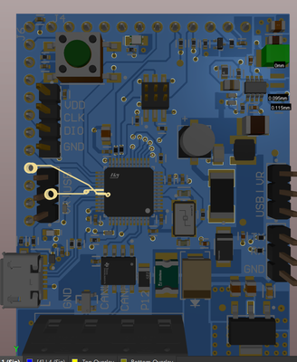

In below image u can see that connection between microcontroller and headers.
I recommend you to check again your hardware especially your connections. Do continuity tests between that "CH340" and the STM32 pins PA9/PA10 and ensure the common ground. For the continuity test you need to power off both your STM32 and CH340.
