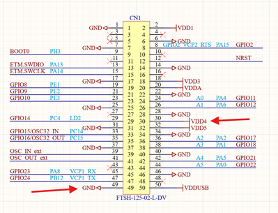

However, we have found something strange while testing the MB2130 evaluation board for this case.

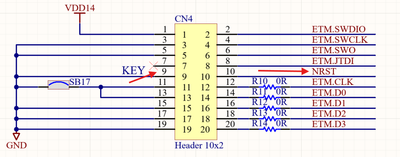

We powered the MB2130 board exclusively through pins 30 (VDD) and 49 (GND) of connector CN1. The NRST signal was held low by shorting pins 10 (NRST) and 9 (GND) of the unequipped CN4 connector. You can see the connection below:
With a supply voltage of +2.8 V and RESET asserted, a constant current consumption of approximately 1 mA was measured.

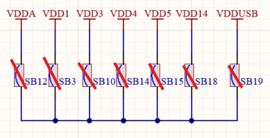

It is worth noting that the different power supply pins of the MCU are NOT short-circuited. The solder bridges SB12, SB3, SB10, SB14, SB15, SB18, and SB19 are open. Additionally, it has been verified with a multimeter that there is no continuity between these pins.

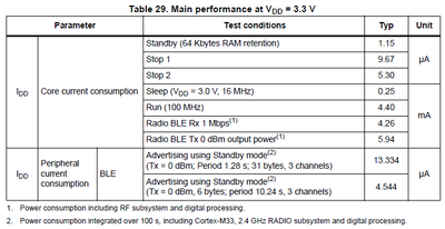

We have checked the datasheet and there is no information about the current consumption in reset state:
Is it 1 mA a reasonable value? It seems too high for us.

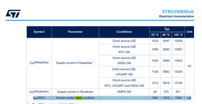

Laurent LOUAZON
1mA is expected if setting reset pin to  low.
Entering in low power mode should (such as 1uA in standby mode) be done through dedicated API.

Laurent LOUAZON
Sorry, just realized I mixed chipset with another topic.
I provided data for STM32WB09, but I would guess this is similar for WBA (agree data is not provided in datasheet)
I would suggest using dedicated APIs for entering low power mode.
