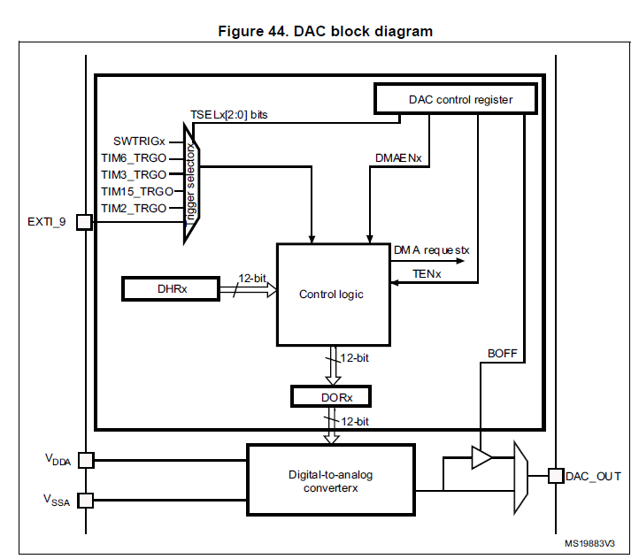

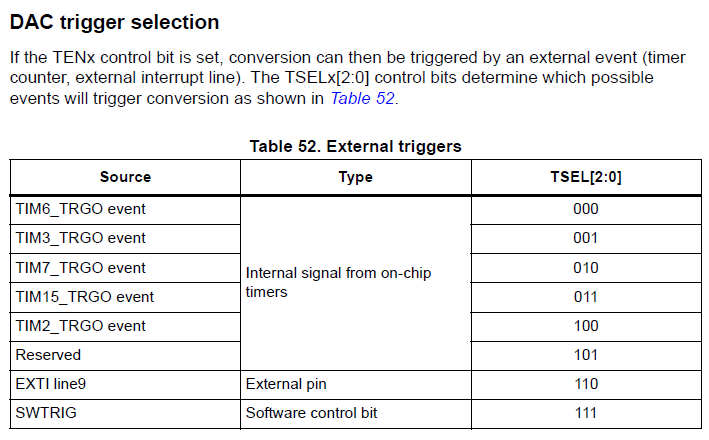

STM32F0x2 RM file DAC trigger source makes confused
Microstar
Can TIM7 set as trigger source?​
waclawek.jan
I would say, yes, you can, in models which have TIM7.
The smaller models' don't have TIM7 -  TIM7 is available only on STM32F07x and STM32F09x devices. The 'F051 was the first 'F0x IIRC, and the figure might have originated there.

DAC block diagram doesn't list TIM7.​
waclawek.jan
And how hard is it to actually try and test?
I'd also expect the library code to expose the list it can manage.

@Imen DAHMEN​  @Khouloud GARSI​ Inconsistent block diagram, from F051/F058 parts
Imen.D
Hello All,
In fact you are correct, the whole TIM7 is not present in the other series (not only the connection).
I raised this internally to the appropriate team for improvement.
Thank you for your help.
Kind Regards,
Imen
