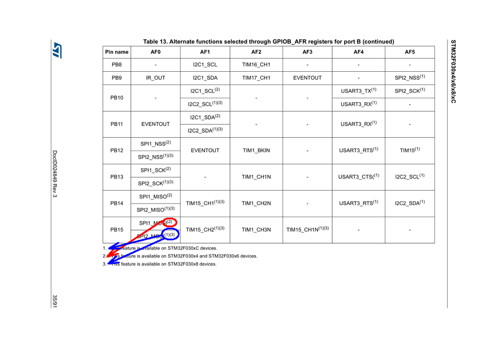

In the STM32F030X8 datasheet the PortB pin 15 alternate function AF0 is both SPI1_MOSI and SPI2_MOSI
(see table 13 on page 35 of en.DM00088500.pdf). The pin 15 is just an example - there are more of such.
How can this be resolved? Is there some other register that specifies the SPI module to connect to the pin?

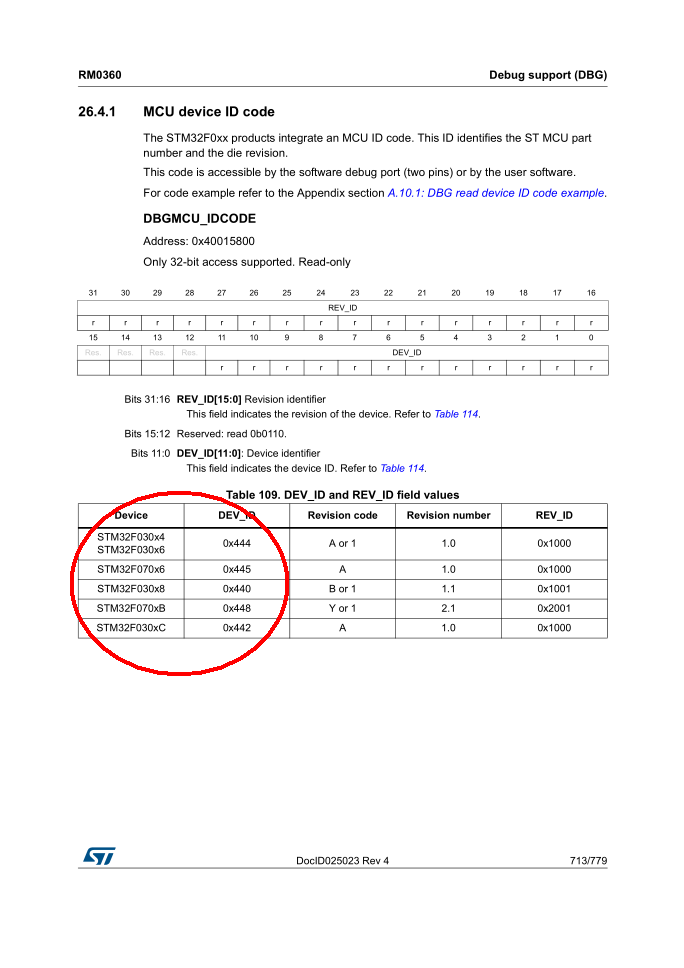

How can this be unclear?
Seems like a bond-out specific
No, these are simply completely different chips.
Btw. do you remember how did the 'F030 happen, that it was clearly said to be only a less-tested 'F051? The 'F030x8 is identical to 'F051.

Look at the alternate function register. Look at table 12 to 16 in the datasheet
Posted on November 09, 2017 at 00:25
Seems like a bond-out specific either/or, should be notes indicating which part provides what. Similar thing goes on with the USART

Posted on November 09, 2017 at 03:03
I was trying to be charitable, as there really shouldn't have been a need to do stupid stuff like this, there are enough empty AF slots for this to have been achieved in a coherent way across die and package combinations.
Perhaps after a long lunch, and high CO2 levels in the conference room?
I would have use some of the empty AF slots on other designs to switch USART RX/TX pairing
Posted on November 09, 2017 at 07:01
Thank you Jan! I read through these remarks several times, but did not get it, untill you point it.

Have also a look at the SYSCFG_CFGR1 for remapping functions.
