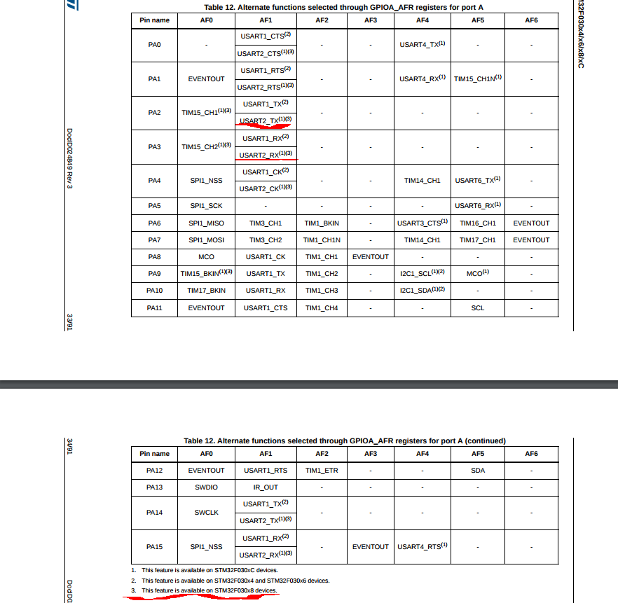

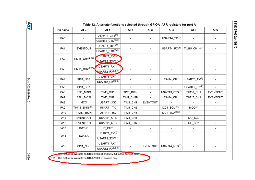

PA2 and PA3 should at least have some connectivity to a USART peripheral, and a free for use on the board.
‎2017-08-24 6:09 AM
OK, so since my device is an STM32F030R8 device, I should be using USART2 with PA2 and PA3, is this correct?
I have just tried this and I am still not seeing anything.
‎2017-08-24 6:26 AM
According to the table from the DS I posted above, there's no USART connectivity on PA2 and PA3 for STM32F030x8.

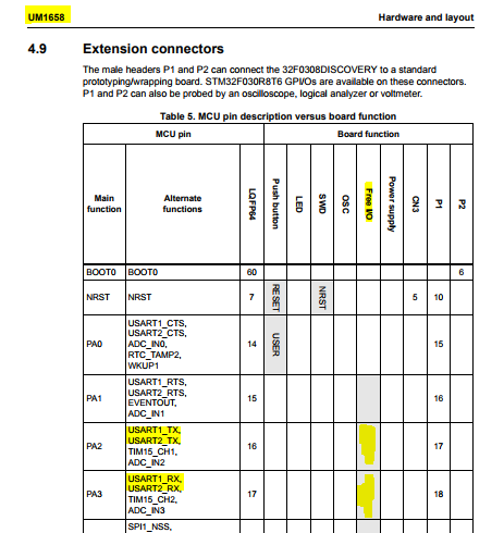

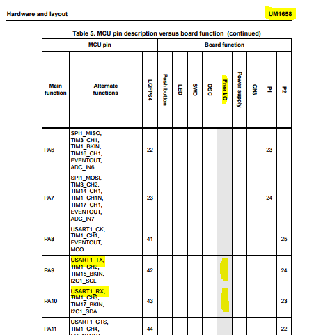

Checking the user's manual of the discovery board there shows that the pins that you are using to uart are free, pages 19 and 20:
By the way, the right pins are PA9 and PA10, there you havean issue.

According to the document provided by
Turvey.Clive.002
, there should be ( see below ). Or am I misunderstanding?I have also tried using USART1 and PA9 and PA10, which should work according to the table below, but I have had no luck.
‎2017-08-24 7:40 AM
I apparently have an older version of DS missing the footnote 3...
Then USART2 on PA2/3 should work.
As Clive said, make sure the pins are free on that board. Check them as GPIO Input/Output.
