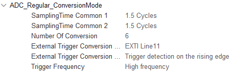

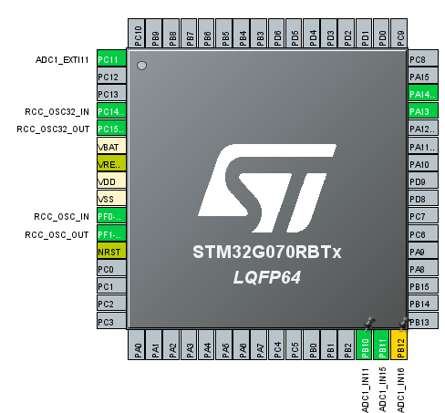

‎2023-04-19 1:58 AM - edited ‎2023-11-20 7:46 AM
maybe i am thinking wrong but you can use the PWM signal for the trigger? with the rising edge so the conversion is almost instan after PWM tigger? In my case (STM32G070RB) it will use the EXT11.
‎2023-04-19 2:50 AM
I am doing this already. This doesn't answer my query.
My question is: Is there a way to manage ADC to run on external trigger for 1 channel and polling for rest of the channels?
