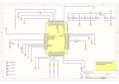

I am using STM32L476RG as a part of my ultrasound project. STM32 basically has the following functions in this system:
  1. Send 3 2MHz pulses every 40ms
  2. Read 500*2 ADC points using an interleaved ADC triggered simultaneously with pulses
  3. Send ADC data through SPI to ESP32
This is my schematic that I will use on my board (The stm32 part of the board, the other parts of the board design is not finished yet)
My firmware code is in the attachments:
I also checked the design self-check guide and everything seemed fine to me. There are some notes in my mind:

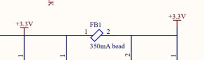

1) The board is supplied by a converted 3.3V from 3.7V battery. I am not sure about the affect and placement of the ferrite bead when using a single 3.3V.
2) Is there a need to add diodes if I channel st-link 3.3V to the start of battery 3.3v line. When the stm32 is powered by stlink would that affect the 3.3V line(Because 3.3V also powers the pulser IC on the same board.
3) I am not using any external crystals because the system is already working fine with HSE, so I thought not to ad any external crystals for size optimization.
4) Do I need external crystals for low power modes? The system is working continiously now but I am thinking of adding a low power state for 5 mins.
Other than these I could not think anything else to consider. I would really appreciate it if you can share your thoughts with me.
A ferrite bead connected to the same net on both sides doesn't do anything.
Schematic otherwise looks okay.
You don't need HSE or LSE for low-power modes.
Recommendations:
  • Use a standard programmer header that can be connected to an official programmer directly. STLINK-V3MINIE works, as does any other. Programmers generally do not provide power.

With so many spare pins, make some testpoints for debug purposes; provide access to a UART.

Thank you for the answer.
I read the application note, that is where I based my design, I may have some missed points tho.
I will add some debugging pins and uart pads thank you.

I realized that if I power it from the same source it wont help but I am not sure what else to do.
Would removing the bead and giving the same 3.3V affet ADC too much.
Or should I divide 3.3V into to lines, use a unity gain buffer and then give it to VDDA maybe?

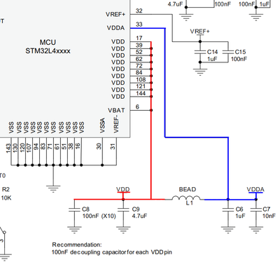

That is shown in the App Note:
So the bead separates VDDA from VDD - it forms a filter between the two.
This is pretty standard - not specific to STM32
eg, https://electronics.stackexchange.com/questions/325810/where-to-put-regulator-when-separating-analog-and-digital-grounds
As well as the schematic, you should also pay attention to layout.
EDIT: added colour
Depends on how precise you your ADC measurements need to be - only you can say what is "too much" in your particular application
I would use the same net for VDD and VDDA. No ferrite bead.
The ferrite bead will slightly help analog performance, but only if there is sufficient EMC in the frequency range attenuated by the bead. It will not make a huge difference. Read about improving ADC accuracy here:

I will update my schematics accordingly. I am just confused about one more thing from the application notes:
In the application note it is mentioned to use a 1nF and a 1uF capacitors. VDDA/VREF+ pins are the same pin in my schematic.
But in ADC optimization it is mentioned to use a single 100nF capacitor for power supply decoupling.
Which one should I follow or are they for different purposes. Also I am thinking of grounding the pins around the ADC pin so that they are always 0 and do not cause any interference
You should use both the 1 uF and the 100 nF. My guess is this is an oversight in the app note as the text explicitly says to use both. There is no technical basis for why a 1 uF would not be needed when the pins are combined, but needed when they are separate.
