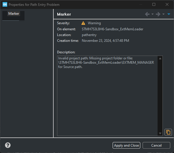

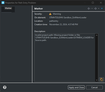

I found some time to play with my NUCLEO-H7S3L8 board again. This time, I forked the GitHub repo from your link. It contains a lot of information, which took me some time to go through. I tried several examples for the NUCLEO-H7S3L8 board, but unfortunately, none of them worked. As the next step, I started a new project and followed the instructions posted by @CMYL as closely as possible. You'll find attached the project I've created that way. What can I say? It doesn't work.
Here are some points I ran into:
1. Generating Code from STM32CubeMX gives me this warning:
2. The ExtMemLoader has two warnings:

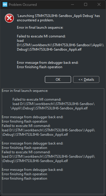

3. It's not possible to start the application:
After that message, I used the STM32CubeProgrammer and erased the flash on the STM32H7S3L8, programmed the "STMH7S3L8H6-Sandbox_Boot" to address 0x08000000, and the "STMH7S3L8H6-Sandbox_Appli" to address 0x70000000. That worked without any issues, but the LEDs stayed dark after I pressed the black reset button. Even a power cycle didn't light up the LEDs.

It was hard to believe that my two boards were not running, so I kept researching. I remembered that a friend of mine that I follow on Instagram workers for STM, and I contacted him to ask about my issue. We had a long video call on Discord and tried various things. Unfortunately, we couldn't find a solution.
Nevertheless, another Google search led me to a post on STM-Community from April this year, where "bashira" had a similar issue. The solution provided by "KDJEM.1" also solved my problem.
Here is the link to this post:
Solved: Re: Nucleo-H7S3L8 Booting to Application via Bootl... - STMicroelectronics Community
The only thing left to wonder is why the XSPI1-HSLV and the XSPI2-HSLV bits were not set in both of my boards. I am glad this problem is solved, and I can play with my two new boards.
