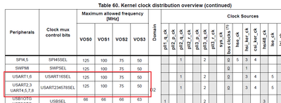

To achieve 20 Mb/s, STM32 UART must be clocked at 160 MHz. Really strange idea, even if possible.

You didn't mention which H7 device you are referring to. But for STM32H74x/STM32H75x you cannot exceed 125MHz at VOS0 from RM0433.

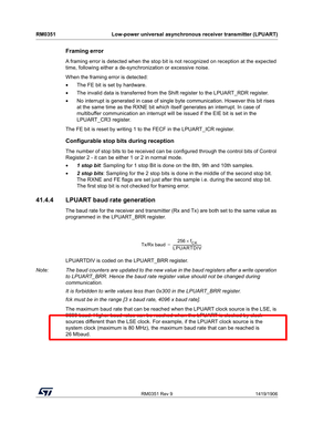

‎2024-11-11 5:38 AM
LPUART may be more flexible in achieving high baudrate-to-clock ratio, for example this is quote from the 'L4 RM:
That does not mean it's a good idea overall.
