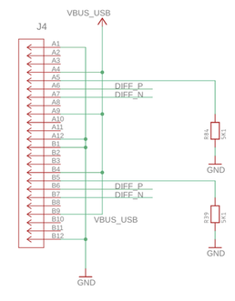

The hardware is as follows (USB Type-C):
Unfortunately, I did not design it, and I currently cannot modify it.

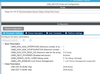

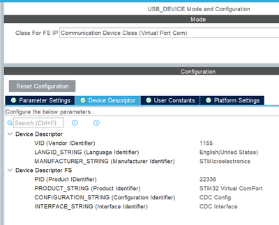

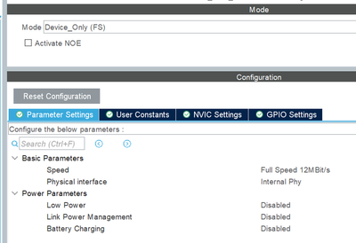

The firmware configuration is as follows:
with USB, UCPD1 and UCPD2 global interrupts enabled.
