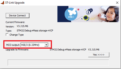

Hi Community,
I am facing very basic issue. My UART in H7A3ZI Nucleo 144 board is not displaying correctly on terminal.
My UART Setting:
huart3.Instance = USART3; huart3.Init.BaudRate = 115200; huart3.Init.WordLength = UART_WORDLENGTH_8B; huart3.Init.StopBits = UART_STOPBITS_1; huart3.Init.Parity = UART_PARITY_NONE; huart3.Init.Mode = UART_MODE_TX_RX; huart3.Init.HwFlowCtl = UART_HWCONTROL_NONE; huart3.Init.OverSampling = UART_OVERSAMPLING_16; huart3.Init.OneBitSampling = UART_ONE_BIT_SAMPLE_DISABLE; huart3.Init.ClockPrescaler = UART_PRESCALER_DIV1; huart3.AdvancedInit.AdvFeatureInit = UART_ADVFEATURE_NO_INIT; if (HAL_UART_Init(&huart3) != HAL_OK)
My Code:
int _write(int file, char *ptr, int len) { HAL_UART_Transmit(&huart3, (uint8_t*)ptr, len, HAL_MAX_DELAY); return len; }
//and
while (1) { /* USER CODE END WHILE */ /* USER CODE BEGIN 3 */ printf("current number is %d\r\n", counter++); HAL_Delay(500); }
My Buad rate is 115200
This is basic code to get UART output data on ST link virtual serial port that is connected to Laptop.

Watch what value HSE_VALUE is using, against the MCO frequency the ST-LINK/V3 is actually generating.
25 MHz / 3 = 8.333333 MHz, not 8.000 MHz
The firmware update tool should provide some clocking options.

Could you please share your ioc file? What clock source you set? HSE or HSI?
If you are using HSE in Bypass mode you need to check the Clock source frequency generated by the ST-LINK over MCO.
Could you please check this information using ST-Link Upgrade tool and see what MCO output is set?
By default it's set to HSE/3 = 8.33MHz
 Thank you SofLit,
You have pointed me in correct direction, earlier it was put up in PLL. Now i have changed it to HSI and it is coming correctly.
Can you please explain why it is so or some link where i can get more details about it?
