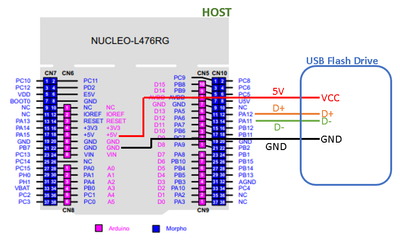

I use the stm32 Nucleo-L476RG to read the total size of USB flash drive and external hard drives, respectively.
It works with USB flash drives, but not with external hard drives. The error message from STM32 is
FR_DISK_ERR (A hard error occurred in the low level disk I/O layer ) when I try to mount the external hard drives.
The wiring diagram is following
Please give me some suggestions to fix this issue. Thanks in advance.

Hello @LeonSu ,
Seems the NUCLEO-L476RG is not layout optimized to interface on PA11/PA12 like a clean USB D+/D- differential tracks. Even if it is only USB Full-Speed, If you add long connection to your external drive, it may not work properly.
5V Power may also be an issue in your context of external drive.
If you don't succeed to solve the problem, other fallback solution could be to use :
- a X-NUCLEO shield (USB host) if compatible with this NUCLEO Board.
- Another Nucleo of another STM32 series offering a true on-board USB Host mode (if it exists)
- More commonly, use Discovery boards or other evaluation boards that offer this kind of feature on a true USB User connector (USB type-C Host capable, or equipped with USB OTG micro A).

Hello @LeonSu ,
I would like to correct a typo on my previous answer :
USB type-C Host capable, or equipped with USB OTG micro AB , which can supply sufficient current "

> " USB type-C Host capable, or equipped with USB OTG micro AB , which can supply sufficient current "
Power supply is one of the issues with external harddisks.
The other is the file system. While I'm not sure about FAT32 support in FatFS, NTFS will definitely be a problem.

Try to debug and find where the mount fails. Does it fail at the block i/o level or in parsing the filesystem structures on the disk?

I tried to analyze the mounting process of USB flash drives and external hard drives in Windows.
It shows that external hard drives use a “bridge” to connect the USB port to the hard drive. The identity of this bridge is completely unknown.
We have sent the information back to the manufacturer for further investigation.
Yes, in Windows USB Mass storage devices are mounted with help of usbstor driver. It registers as driver for the hardware bridge device; it's vendor ID can be seen in the Device Manager.
For some other device types it can be uaspstor instead of usbstor, this isn't likely your case.
