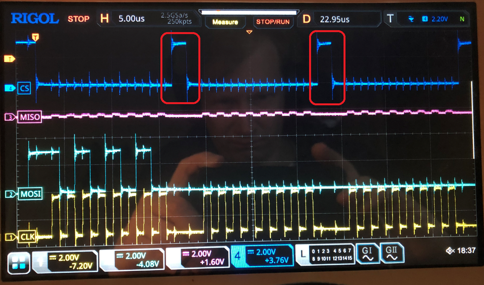

at the moment I try to get a Sensor working, I use the HAL_SPI_TransmitReceive_IT and HAL_SPI_TransmitReceive_DMA functions.:
The settings I used are:
  • Mode: Full Duplex Master
  • NSS: Hardware Output; has Low-Enables Slave-Select.
  • Frame-Format: Motorola
  • Data-Size: 8 Bits
  • First Bit: MSB First
  • CPOL: 0 = Low ; Clock Polarity starts low,
  • CPHA: 0= 1st Edge ; Clock Phase is the first edge

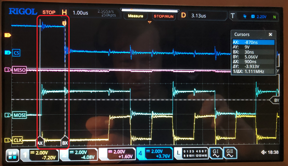

I have discovered two things that I did not expect:
  1. The nSS(negative Chip-Select) is active after the MOSI, how can that be changed, so I get a longer CS?
  2. The nSS(negative Chip-Select) does not stay low, how can I change it to stay long for the duration of the entire transfer?

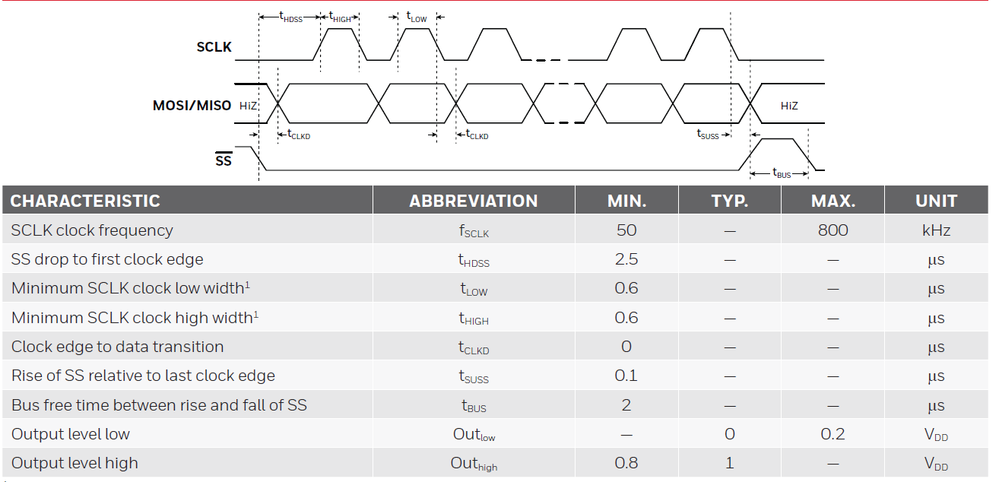

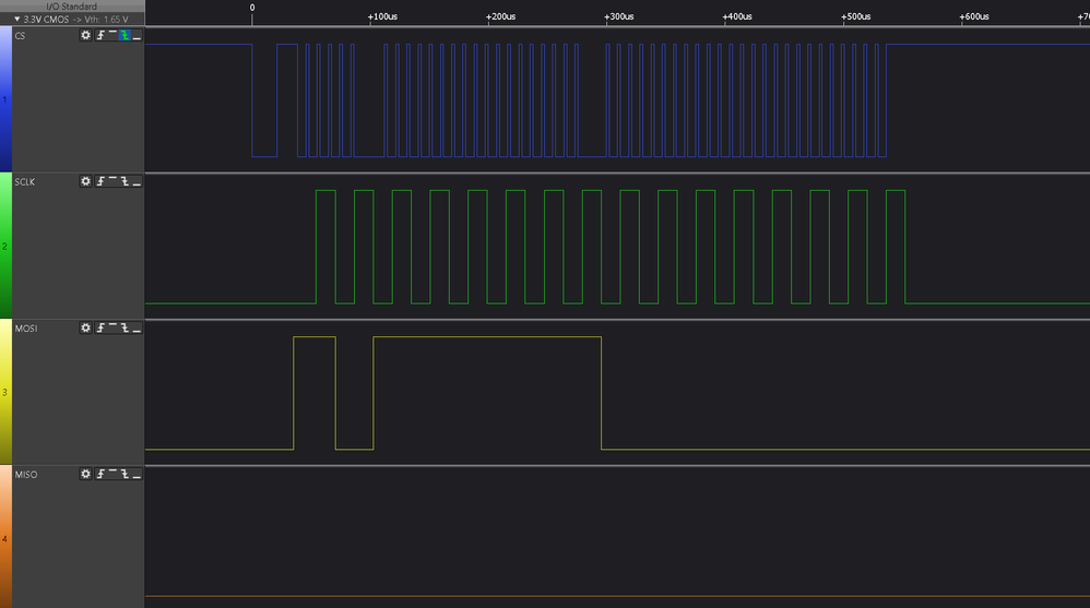

If I change ti TI mode the Signals look like the following diagram, which is not matching the specification either.
Can someone give some suggestions on how to fix the issue or the limitations of the SPI-Controller of the STM32(G4)?
Thanks a lot.
Best Regars, Seppeltronics

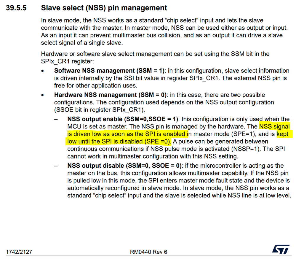

I mean that it does not work the way you're expecting it to work, assuming you want it to go low just prior to the transaction and high just after. The details are in the reference manual, but the short answer is that it is low as long as the SPI is enabled (barring TI mode, which has the pulse on the first bit). And the HAL library generally doesn't disable the peripheral between HAL_SPI_* calls.

What you show in the first screenshot is NSS Pulse Mode (it is better to use terms from RM rather than any Cube lingo, not everybody uses Cube).
NSS is mostly unusable as automatic framing. As TDK said, set it to Out and handle "manually".

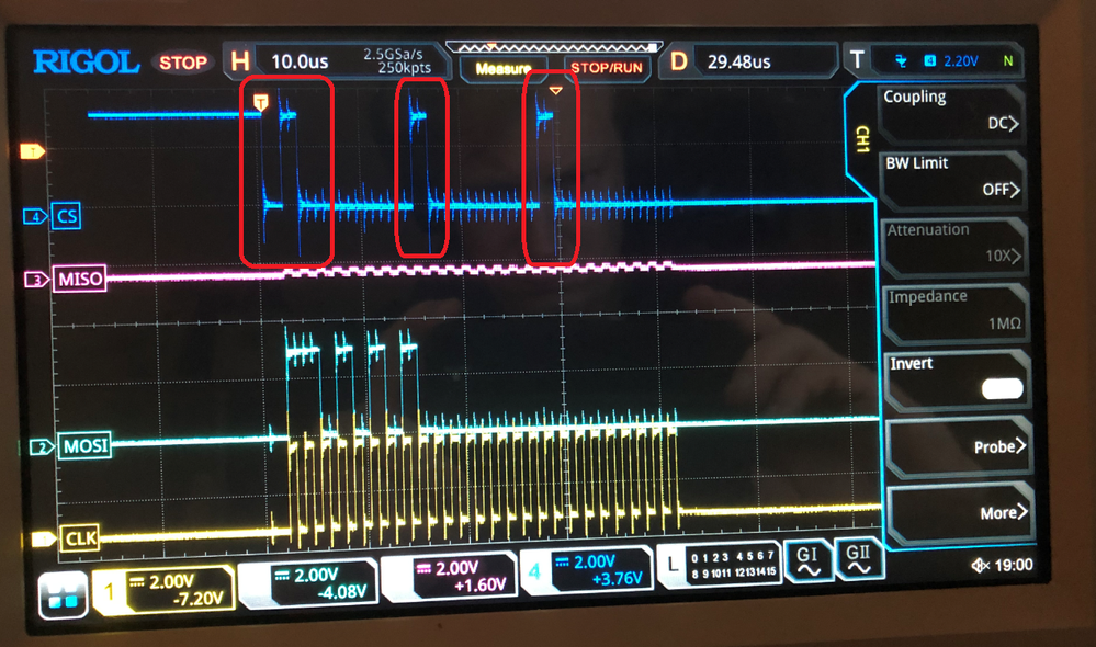

I have the same issues as with HAL_SPI_TransmitReceive_IT(). In polling mode everything works fine, I handle the NSS, as mentioned
 HAL_GPIO_WritePin(GPIOA, SPI1_NSS_Pin, GPIO_PIN_RESET);
 data = HAL_SPI_TransmitReceive_IT(&hspi1, tx_data, rx_data, 2);
 HAL_GPIO_WritePin(GPIOA, SPI1_NSS_Pin, GPIO_PIN_SET);
However, in interrupt mode NSS is pulses in and not like it pulses in TI_MODE after every byte. Also, I do not have configured in TI_MODE.
0693W00000bh8MJQAY.pngAs can be seen from the above image the blue signal is NSS pin, which is configure as GPIO Output. Something in HAL_SPI_TransmitReceive_IT() is toggle the pin, and check the register SSM and SSI SSOE are all correct at least from what I can determine from the datasheet and SFRs.
Anybody have an idea what can be the isseu?
it seem as the STM32's SPI is not what I expected. The way I currently solved it is:
