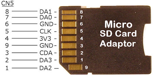

>Do the SDIO mean boards have their own SD card adapter onboard?
no, just the chip needs to have the SDIO (4bit) peripheral;

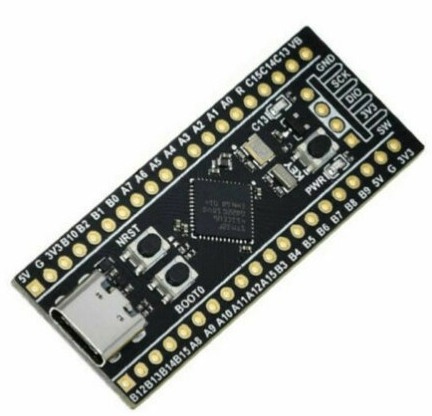

0693W00000aICYjQAO.pngi have here a "black pill" board with stm32F411 cpu, 9 short (7cm) wires to a micro/SDcard adapter;
0693W00000aICYFQA4.pngworking fine; got about 2MB/s average speed, so could work for your sampling.
but what you wanna do at all , with 1 Msample continuous data ?? is about 8GB in one hour - and then ??

It will be just a very simple radar application, I'm trying to convert received signals. For the SDIO, just soldering wires to the adapter will work as I understand. And, I will need to figure out how to use ethernet also.
