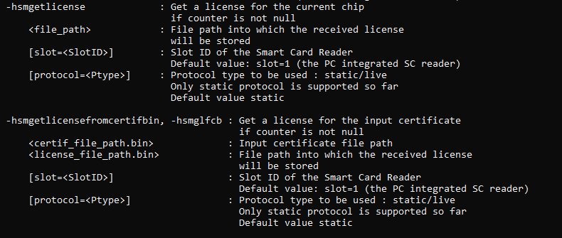

Where can I find algorithm to generate license file for SFI upload to STM32U585?
SBalo.1
I'd like to use my own server instead of HSM card. I can't find any information how the license file is generated except the fact that it is possible as mentioned in AN5054.
Slawek
SBalo.1
Thank you Chloe.
I guess there is a private key in HSM card provided by ST, which is used to sign generated licence file which is then used to allow secure bootloader to receive SFI. ST wrote in AN5054 "There is no STMicroelectronics secret involved in license generation, so each firmware provider is free to choose their preferred method.", except the must for buying a limited HSM card - am I right?
Best Regards
Slawek

Hello Slawek,
Did you try the CLI STM32CubeProgrammer commands :
0693W00000bhPlaQAE.pngBR
Chloé
SBalo.1
Hello Chloe,
thank you for the answer. I understand these CLI commands as getting the license from attached Smart Card Reader with HSM card inserted - or am I wrong? Both have description "...if counter is not null".
SBalo.1
My goal is to prepare software/server to create this file by myself - of course getting ID from programmed microcontroller and using my own nonce/AES key which were used to encrypt firmware (SFI).

Hello Slawek,
" I understand these CLI commands as getting the license from attached Smart Card Reader with HSM card inserted - or am I wrong?" : In fact you need an HSM to do that.
You can't perform all these operations without any HSM.
Best Regards
Chloé
SBalo.1
Thank you Chloe.
Best Regards
Slawek
Chloe Meunier
Yes your are right.
Best Regards
Chloé
SBalo.1
Thank you Chloe, now it's clear.
