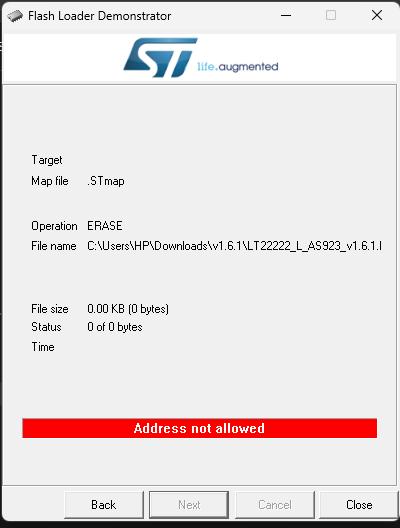

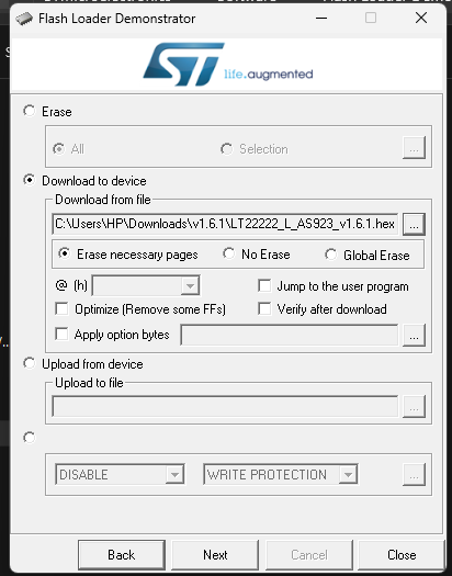

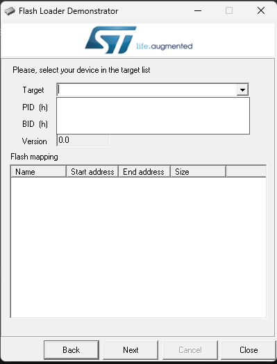

I am currently working on downloading an image into the LT-22222-L using the STM32 Flash Loader. While the download completes successfully and runs as expected, I am encountering significant issues with the application. It frequently crashes, and on the rare occasions when it remains stable, all options within the application appear empty.
I would appreciate your prompt assistance in resolving these issues.

Welcome @nabihah_ali, to the community!
First of all, a note: you are asking for support for the FLASHER-STM32, which is deprecated and on NRND (Not Recommended for New Design).
Then: this outdated software obviously does not work with a third-party system (Dragomino), for which you should better ask this manufacturer. But I asked my search engine, which gave me e.g. this URL with the following statement:
For flashing I used the STM32CubeProgrammer.
The recommended STM32 Flash loader demonstrator (FLASHER-STM32) did not work for me.
Hope that helps?
Good luck!
/Peter
