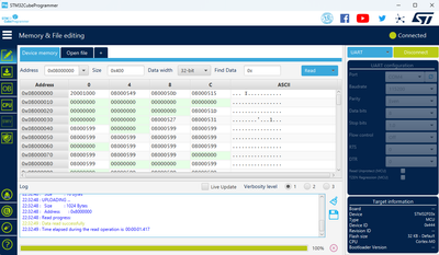

‎2024-07-27 8:04 PM
I got it to work!
All I needed to do was set the BOOT0 Pin high when uploading the code, then in PuTTy set it to COM4 with a baud rate of 115200 b/s. After that, by hitting the NRST pin I can display my text on the UART terminal! I still don't know if there is a way to upload code directly via my USB port, but this was the more important problem I was trying to figure out initially.
‎2024-07-27 7:05 PM - edited ‎2024-07-27 7:13 PM
To upload code via the UART bootloader, boot into the bootloader by holding BOOT0 high during reset, use STM32CubeProgrammer, then select UART and the COM port it's connected to.
You're using an FT230X chip, which is a UART to USB device. It's going to appear as a generic serial port, but that's not a problem for anything.
> I can upload code via my ST-LINK and pogo pin header
Why not continue to use SWD to debug/program the board?
The bootloader on the STM32 resides in ROM. It is not something that needs to be installed--it is always there. Sometimes, users install custom bootloaders, but that is different from the system bootloader.
‎2024-07-27 7:34 PM
There's no way I can directly upload code via USB for my device on STM32Cube IDE? That was my original intention with this board as I wanted to upload code without having to use the ST-Link every time and read it from PuTTy.
The device was able to be read in the STM32Cube Programmer which is a good sign:
But now how do I upload code directly in Cube IDE via USB? or is that not possible with the given UART ic I selected?
