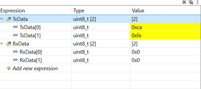

In your code, you send and receive once in polling mode. So I don't know how you test that and what you expect as a behavior.
if( HAL_CAN_AddTxMessage(&hcan, &TxHeader, TxData, &TxMailbox) != HAL_OK) { Error_Handler(); } while(HAL_CAN_GetTxMailboxesFreeLevel(&hcan) != HAL_OK){} if(HAL_CAN_GetRxFifoFillLevel(&hcan, CAN_RX_FIFO0) != HAL_OK) { Error_Handler(); } if(HAL_CAN_GetRxMessage(&hcan, CAN_RX_FIFO0, &RxHeader, RxData) != HAL_OK) { Error_Handler(); }
I modified your project (in attachement) to work in RX FIFO interrupt mode. SystemClock at 48MHz / CAN bitrate at 500kb/s (modified the prescaler, BS1 and BS2 with recommended values).
Unfortunately I don't have a board to test that MCU part number. So you need to test it from your side: in the Live Expression check RxData[].
Hope it helps.

I have made the changes you suggested. But still also I am  getting the same.

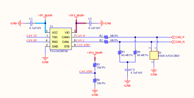

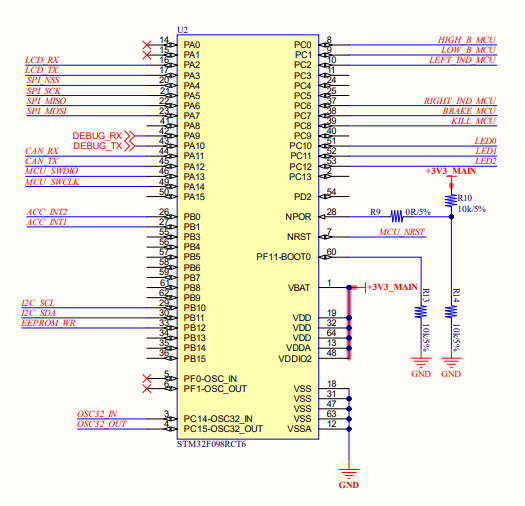

  • I have two custom boards with STM32F098RCT6 & TJA1042 transceiver and I am trying to communicate with each other. I provided 12V supply to both the board and connected CAN_Tx and CAN_Rx pin of the two boards.
  • In each board there is only  STM32F098RCT6 & TJA1042 in the CAN bus.
1- Same HW for the two boards?
2- Need to provide schematics.
3- Again please share the all project by compressing it in .7z format and drag and drop it here. Other compressed file formats are not supported.
Yes, same HW for both two boards.
Here is the schematics:
