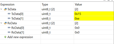

I modified your project (in attachement) to work in RX FIFO interrupt mode. SystemClock at 48MHz / CAN bitrate at 500kb/s (modified the prescaler, BS1 and BS2 with recommended values).
Unfortunately I don't have a board to test that MCU part number. So you need to test it from your side: in the Live Expression check RxData[].
Hope it helps.

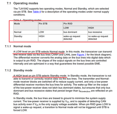

The circuit on CAN_STBY is putting the TJA1042BT probably in standby. The STB pin is a digital input, so setting it to 1.6V is definitively not a good idea. Please remove R5 to enable the Driver.
Martin
Martin
Yes it could be related to this.
I tried the interrupt code you have provided. But there is no change. Nothing is receiving as RxData.
  • And removed the R5 and checked again, again there is no change.

Thank You all for reply.
The issue was related to the standby pin on the transceiver. I started receiving data once the STBY pin was set to low.
